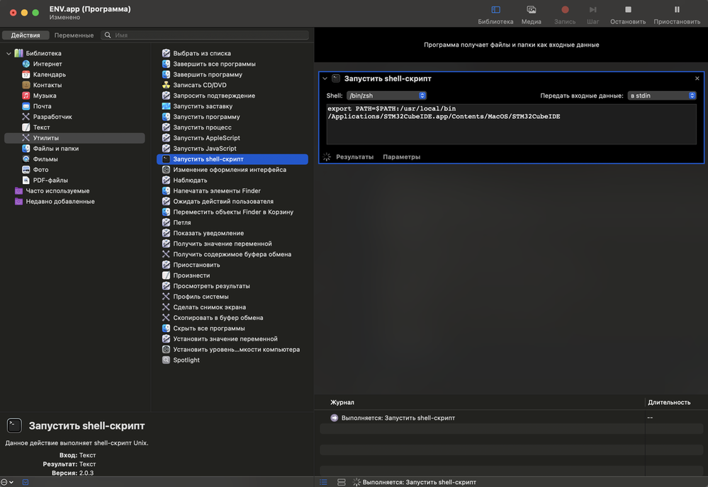

Hi everyone. I did a bit of research on this issue and found that the debugger fails to launch due to the missing environment variable /usr/local/bin. The problem is that when the program is started from Launchpad or from the terminal, the set of environment variables available to the program is different. When launched from the terminal, /usr/local/bin is included in the PATH, but it’s missing when launched from the shortcut.
I couldn’t find an easy way to add an environment variable to Launchpad, and I don’t think that’s the best approach anyway. A temporary solution is to create a shell script through Automator, as shown in the screenshot.
