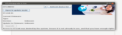

CubeIDE on Linux can detect the existence of the ST-LINK V2 debugger I'm using. If I click Help->ST-LINK Upgrade, the debugger is shown in the dropdown list, and if the debugger is not plugged in, it disappears from the dropdown list. However, as shown in the image, ST-Link ID isn't shown, even after I refresh the device list. Clicking "Open in upgrade mode" results in the "Access to ST-Link was denied by the system..." error shown in the image below.

Is there other running program that uses the st-link? only one app can access St-Link at any time.
Check that udev rules on your system allow your user to access the st-link.
