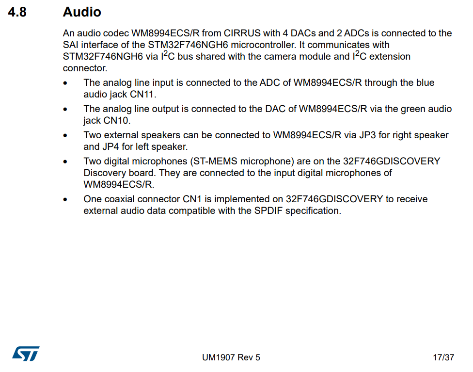

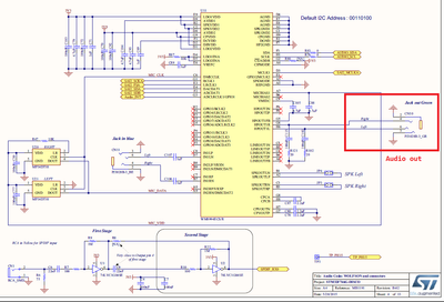

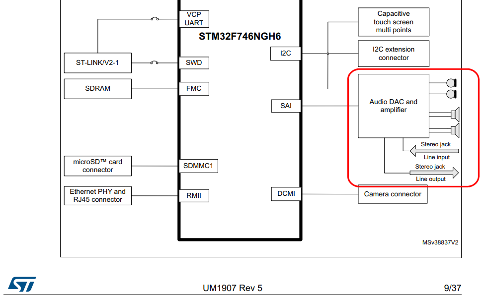

    I work with STM32F746G-Disco board. It has stereo output (two jacks). I just want to direct my signal to stereo but I don't know how to do it.

    In that case, you need to use the audio codec on the board.
    And its BSP driver from the link:
    https://github.com/STMicroelectronics/32f746gdiscovery-bsp/blob/64c20f758a907cd873e368502cf16e498934d0ec/stm32746g_discovery_audio.c
    And refer to the audio example:
    https://github.com/STMicroelectronics/STM32CubeF7/tree/master/Projects/STM32746G-Discovery/Applications/Audio/Audio_playback_and_record
