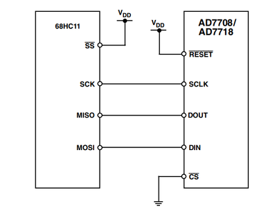

Hello everyone im currently working on a adc AD7708. I want to read chip from the device but i cant get any valid value. Here is the register sturucture of AD7708:
I wrote a basic code to read the chip id from id register. Here is the code:

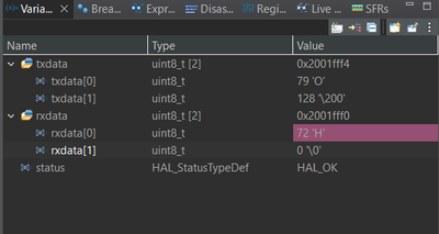

yes i did now. The code looks like this:
  /* USER CODE BEGIN 2 */
  	uint8_t txdata[2];
    uint8_t rxdata[2] = {0x00, 0x00};
    HAL_StatusTypeDef status;
    //first byte setting up the comm register.
    //second byte writing to the mode register
    txdata[0] = 0x01;
    txdata[1] = 0x12;
    HAL_GPIO_WritePin(SPI1_CS_GPIO_Port, SPI1_CS_Pin, 0);
    status = HAL_SPI_TransmitReceive(&hspi1, txdata, rxdata, 2, 250);
    HAL_GPIO_WritePin(SPI1_CS_GPIO_Port, SPI1_CS_Pin, 1);
    txdata[0] = 0x4f; //read operation from id register (im setting the comm register)
    txdata[1] = 0x80;  //dummy data for response
  /* USER CODE END 2 */
  /* Infinite loop */
  /* USER CODE BEGIN WHILE */
  while (1)
	    status = HAL_SPI_TransmitReceive(&hspi1, txdata, rxdata, 2, 250); //rxdata[1] will be my chip id register value
	    HAL_Delay(10);
    /* USER CODE END WHILE */
    /* USER CODE BEGIN 3 */
  /* USER CODE END 3 */
The result:
rxdata[1] is still 0. Is there somehing else that i should try?

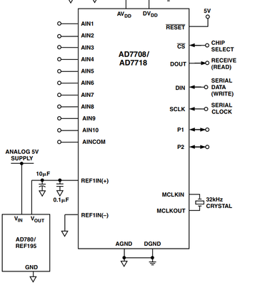

Hardware is like this : avdd, dvdd = 3,3V ?
+ look with scope on the lines...mosi , miso ...see something?

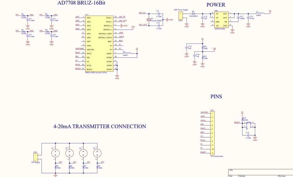

vdd's = 5v and my CS pin connected to my mcu (STM32f446RET6 Nucleo). I have already look looked with scope and i can see my MOSI (0b01001111) as i send it. But there is no signal in MISO line only small fluctuations.
STM32 is a 3,3V system, so use also 3v3 on DVDD or both vdd's on ADC.
+ reset ? 32k crystal running ? whats on refin+ ?
Here is the schematic
ok .
STM32 is a 3,3V system, so use also 3v3 on DVDD.
C9 /10 = ?
yes 32k crystal is running. c9 and c10 22pF.
