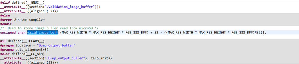

Hello everyone,

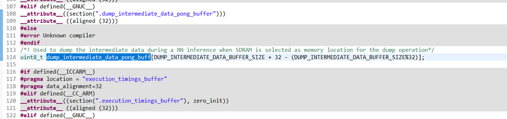

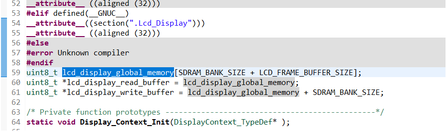

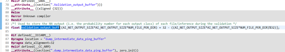

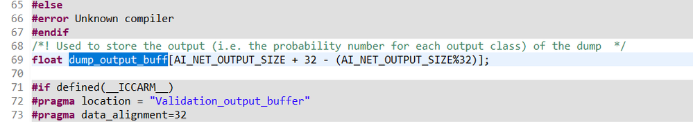

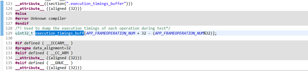

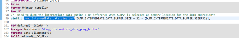

I faced an error with my .ld file. the .sdram_section will not fit into the SDRAM (8MB)
how to solve this?
thanks
That's not problem with the .ld file, it's a problem with your program. You try to put too many things into the SDRAM.
How to solve it then?
waclawek.jan
Reduce the number of data you are trying to put it in there.
How do you solve if the files won't fit onto your USB FLASH stick?
How do you solve, if the baggage won't fit into your car?
Yes but I can’t, If i do so, I’ll lose data and then the image on screen will be whatever
Figure out why you need 12MB+ of RAM
What are you using it for?
Can you fold any of the usage? ie does it all need to be used concurrently, or could it be shared or allocated dynamically.
Put static images into QSPI Flash.​
Try write here declaration of sdram arrays or check if you use proper types.
Example: RGB888 need unsigned char fb[WxHx3], when you write only unsigned you reserve 4xbigger buffer as you need.

If the SDRAM can't hold all the data you either need to make smaller demands on it, or get a board with more memory
When the Linker fails, you could make the SDRAM size larger in the linker script, you'd do this temporarily so you can see who is eating all the resources in the .MAP file.
You're not going to be able to hold millions of floats, each takes 4 bytes
Going to need to be realistic about the constraints of the embedded system. You don't have GB's of space to work with
