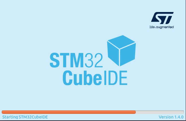

After installing update 1.4.1 the splash field showing 1.4.0 has not changed.
It continues even after opening and closing several times.
In Windows I noticed that this occurs only once, then the number is corrected.

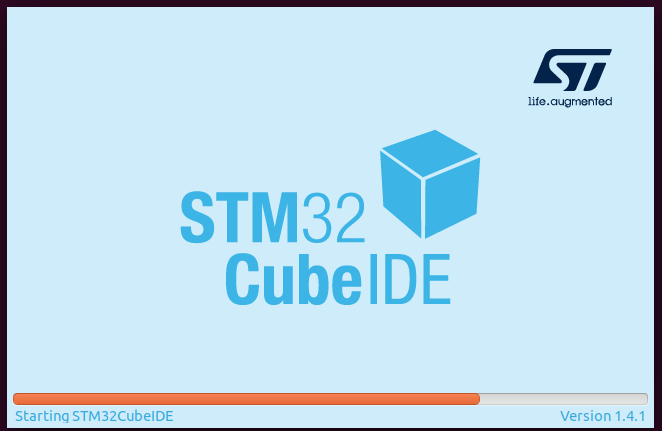

Do you use the restart button (Menu: File -> Restart) to close/open the CubeIDE?
Because just after the update if you still only use the restart button the splash field is not updated:
But then as soon as you close the CubeIDE through red cross or File -> Exit menu the splash field is updated:
