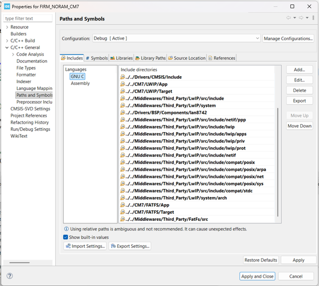

I'm incluse in propities this library:
but not find, any sugestion?

JEAN_121188
Hello!!!
The problem today resolved!!! two methods are used: firts the solution by @Andrew Neil with solution of the occurrence of the "dangerous relocation: unsupported relocation.
Secound with Brasil support ST: Was movie archive of the comum path from projetc:
I would like to thank everyone who helped me @Mahmoud Ben Romdhane @Saket_Om and @Andrew Neil
