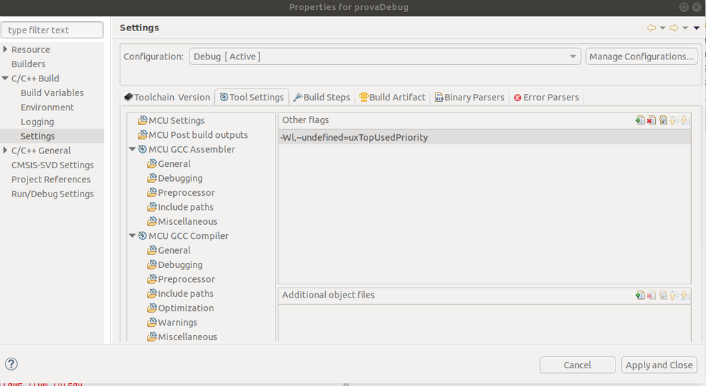

@JBeca.1 I don't see that error. It suggests your RTOS is not linked in. I did notice this other part that I had applied though.
Put this in a .C file:
#include "FreeRTOS.h"
#ifdef __GNUC__
#define USED __attribute__((used))
#else
#define USED
#endif
const int USED uxTopUsedPriority = configMAX_PRIORITIES - 1;
 And put this in the linker settings:
-Wl,--undefined=uxTopUsedPriority
And here's the guide I used to figure it out.
https://mcuoneclipse.com/2016/04/09/freertos-thread-debugging-with-eclipse-and-openocd/
JBeca.1
HI @Panometric​ ,
thanks for your support. I tried it... but it doesn't work.
I added the code in main.c
And the linker setting I added in build options (see image)
I can "enter in debug mode" but debugger not works. The eclipse show that app is running, but I can't resume, stop, step, ... and board doesn't do a nything
I attach the console output
Thanks for your tiem
Regards
Jordi
