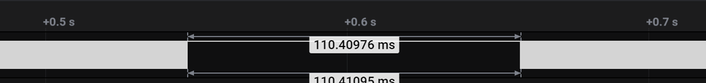

‎2021-11-04 7:19 AM
> You could toggle a pin in a tight loop and verify.
I did this. On an F429, setting a hardware breakpoint while the program is running halts the CPU for 110ms. Certainly explains the issue. Likely setting DBG_WWDG_STOP would prevent the WWDG from resetting here.
‎2021-11-05 4:05 AM
Whoa! Thanks. I wouldn't have guessed it's that much.
But DBG_WWDG_STOP is already set when configuring, it always was, from the beginning.
I searched in the project for all places where DBGMCU->APB1FZ is accessed, there is only that one place, so it's not accidentally erased again anywhere or something.
I also found that CubeIDE has a setting for debug configuration, in the Debugger tab, Device settings, "Suspend wachdog counters while halted", that sounds like it is that. It was on "Disabled" in the beginning, so maybe it overwrites this setting... I set it to Enabled, that didn't change anything.
