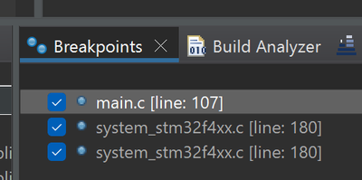

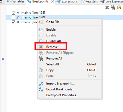

Open the breakpoints tab. Right click to remove a breakpoint.
If that's not working, show screenshots of what's happening on your side.

Hello @GS2 ,
1-
2-
Window -> Show View -> Other -> Breakpoints

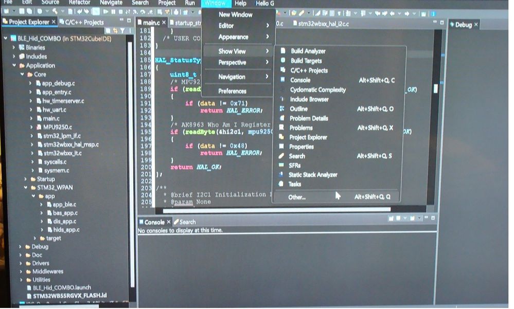

Thank you SofLit,
My "Window/Show View" does not have "Breakpoints" !
Window -> Show View -> Other -> NO - Breakpoints !
Please show a screenshot of your entire window which shows this.
GS2
Senior II
STM32CUBEideSTM32CUBEide
GS2
Senior II
Sorry, find under Debug: Window -> Show View -> Other -> DEBUG --> Breakpoints
and thanks was able to remove all !
