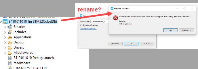

How can I rename the project-name in STM32CubeIDE ?
If I right click on the project(name) and choose rename I get the following error, see attached screenshot.
Thank you
Foued_KH
Hello @pk84​,
Edit the name in the .project file. By default, the name is the root path of the application, but can be changed.

ok thanks, will all other files like .launch be renamed automatically? I think there are for sure some more files with the project name and reference to it?
It's just necessary to change the name of the project and everything works fine :beaming_face_with_smiling_eyes:

Ok that works, but just another, similar question:
Is it possible to change the name of the .launch file? And where can I change the names of the generated .elf/.hex./list/.map ... files?
