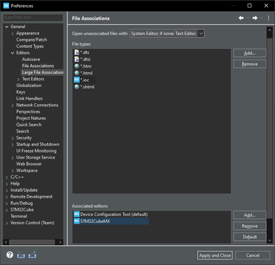

As an alternative to that approach the use can manually do this play with the file associations instead to force ioc-files to be opened with MX stand-alone:
Word of caution: If you set the "STM32CubeMX" editor as "Default" the project wizard will break :(
Internal ticket reference: 139637

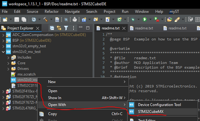

My recommendation would be to just add this "editor" but not set it as Default. Means double-click on ioc-file will still open it inside the IDE. But, use this flow to open the ioc-file with MX stand-alone. A little bit less convenient than a double-click. But the project wizard remains functional.
I don't know if that is useful or not? In theory, you can now use whichever external MX tool you want to configure and generate the project. Keep in mind that this is not a validated use case. But I still think it can be helpful in many cases.
