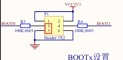

@alphanov wrote:
I have just checked the levels on the BOOT0 pins. There is 3V3 on one outer pin and 0V on the other outer pin. With the header link in the program setting the appropriate voltage (3V3 is present on the centre pin.
Sorry I didn't understand this statement. Did you test the voltage level directly on the MCU BOOT0 pin?
I recommend you to check if BOOT0 pin of the MCU is connected to the GND using a multimeter continuity with the board powered off.
Hello Sorry for the delay.  I have, finally, managed to read the resistance value between the BOOT0 pi (44 on MCU) and the BOOT0 jumper centre pin.  This is 10k Ohm and, when the jumper is at 0 position, the same value is with reference to ground.
I've downloaded a Bluepill schematic and this value agrees with what is shown on there.  I measured it both at the board via at the side of the chip and actually on MCU pin 44.
 You need to put the jumper of BOOT0 on P1 to connect the pins 3-5:
