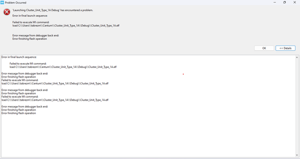

We are facing issue is  " Not able to load/dump code via ST -LINK Programmer " and it's showing as error mentioned below. please help us to resolve this kind of issues or please suggest any idea to implement it as soon possible.

Error: Data mismatch found at address  0x08000002 (byte = 0x00 instead of 0x08)
Error: Download verification failed
Encountered Error when opening C:\ST\STM32CubeIDE_1.16.0\STM32CubeIDE\plugins\com.st.stm32cube.ide.mcu.externaltools.cubeprogrammer.win32_2.1.400.202404281720\tools\bin\STM32_Programmer_CLI.exe
Error in STM32CubeProgrammer

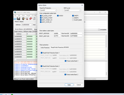

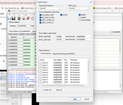

Check banking in Option Bytes, show options.

 Option Bytes,

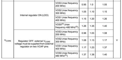

@LokeshIchchangi wrote:
@Tesla DeLorean
especially VCAP capacitor values placed, and observed voltage on pins --> where these will get pls let us know??
In the datasheet:
Also Use STM32CubeProgrammer tool instead of STLINK-Utility as it is obsolete.
@Tesla DeLorean
VCAP capacitor is placed and observed voltage is at VCAP 1 and 2 is  1.0 volt.

Should be closer to 1.25V
Capacitors, multiple 2.2uF each, or single common 4.7uF. The values here are important, you need adequate bulk capacitance.

Show Option Bytes from STM32 Cube Programmer, the old ST-LINK Utiities haven't been updated in a few years. Try doing a write/verify of a 2MB binary file to confirm functionality there.
