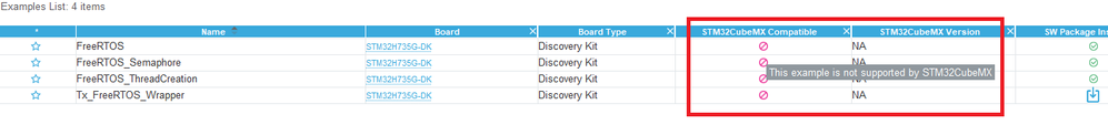

Please help run the example 'FreeRTOS' from 'Example Selector' on STM32H735G-DK board, can't understand how to configure it and where to find 'memory.h' file

Hello @VBout.2​,
The FreeRTOS example from 'Example Selector' for STM32H735G-DK is not supported by STM32CubeMX.
0693W00000WJJbMQAX.pngYou can start your project from scratch following the instructions to configure FreeRTOS in the section 4.4.15 FreeRTOS configuration panel, in the UM1718.
You can also refer to the working example available in the STM32CubeH7 MCU package:
\Projects\STM32H735G-DK\Applications\FreeRTOS
You can modify this working application depending on your needs.

VBout.2
@Imen DAHMEN​
I have use STM32CubeIDE, not CubeMX
I try to run the example on STM32H735G-DK board
The CubeH7 is already installed as a package under CubeIDE
but I still don't understand how to run FreeRTOS example with my STM32H735G-DK board, which project, and how I need to open or import or make with 'Example Selector'
Thank you
VBout.2
It is possible to run LedToggle and FreeRTOS demos with the following config:
