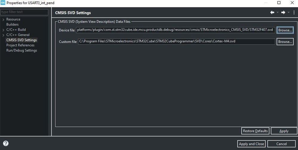

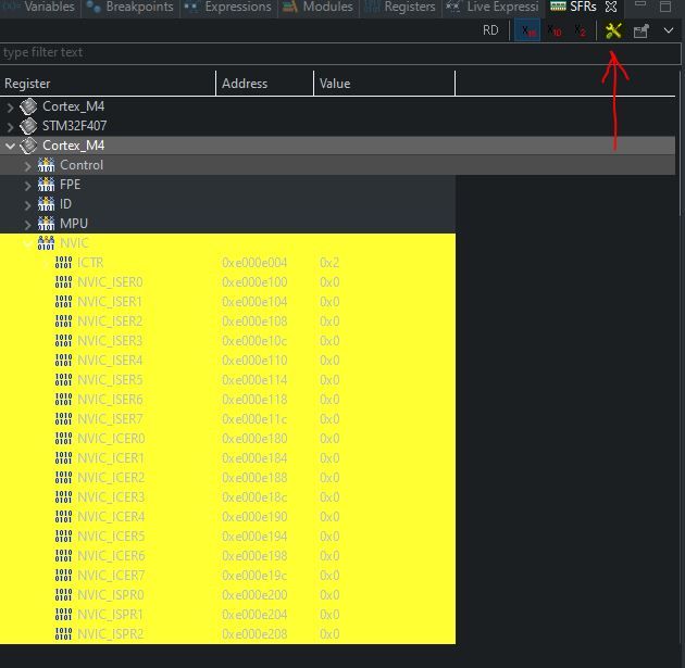

I am using STM32F446RE. I am using the STM32CubeIDE. As STM32F446RE is Cortex-M4 based processor I have also gone through the M4 generic user guide and found that the range of NVIC_ISER0- NVIC_ISER7 is 0xE000E100- 0xE000E11C. But when I ran the code in debug mode and go to the NVIC registers I see the below addresses.
0693W00000BaBsyQAF.pngCan I resolve this issue or is it hardware issue?
Can anyone help please

I found all mine .svd file from command prompt:
open cmd and excute this command: C:\>where /r c: "*.svd"
and Then you will see there is svd files:
C:\Program Files\STMicroelectronics\STM32Cube\STM32CubeProgrammer\SVD\Cores\Cortex-M0plus.svd
C:\Program Files\STMicroelectronics\STM32Cube\STM32CubeProgrammer\SVD\Cores\Cortex-M3.svd
C:\Program Files\STMicroelectronics\STM32Cube\STM32CubeProgrammer\SVD\Cores\Cortex-M33.svd
C:\Program Files\STMicroelectronics\STM32Cube\STM32CubeProgrammer\SVD\Cores\Cortex-M4.svd
C:\Program Files\STMicroelectronics\STM32Cube\STM32CubeProgrammer\SVD\Cores\Cortex-M7.svd
**I just opened Cortex-M4.svd file and searched NVIC ISER0 and ISER1 . I saw offset address are wrong "<addressOffset>0xFC</addressOffset>"
I changed it and ı debuged my code and I opened NVIC registers MAP. But guys over there you will see a tools change. U need use your customer svd file as a this file
where it is "C:\Program Files\STMicroelectronics\STM32Cube\STM32CubeProgrammer\SVD\Cores\Cortex-M4.svd"
here is how I changed:

e.oztoklu
Finally, They fixed with new update
Version: 1.7.0
Build: 10852_20210715_0634 (UTC)
