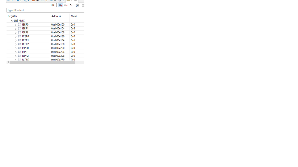

I am using STM32F446RE. I am using the STM32CubeIDE. As STM32F446RE is Cortex-M4 based processor I have also gone through the M4 generic user guide and found that the range of NVIC_ISER0- NVIC_ISER7 is 0xE000E100- 0xE000E11C. But when I ran the code in debug mode and go to the NVIC registers I see the below addresses.
0693W00000BaBsyQAF.pngCan I resolve this issue or is it hardware issue?
Can anyone help please

Registers are described in SVD files. The one in your picture seems to be wrong. Probably you can try replacing it from there:
https://www.st.com/en/microcontrollers-microprocessors/stm32f446re.html#cad-resources

June 5, 2021
@Piranha​ Thanks for your response.
Now the address got changed but still not matching with the  M4 generic user guide ( NVIC_ISER0- NVIC_ISER7 --> 0xE000E100- 0xE000E11C)
June 5, 2021
The SVD file from the link provided by Piranha doesn't even have ISER3-7 registers, and the values for ISER0-2 are correct. Are you sure you replaced the correct file?
It's a text file. You can open it and verify the values in the SVD are correct.

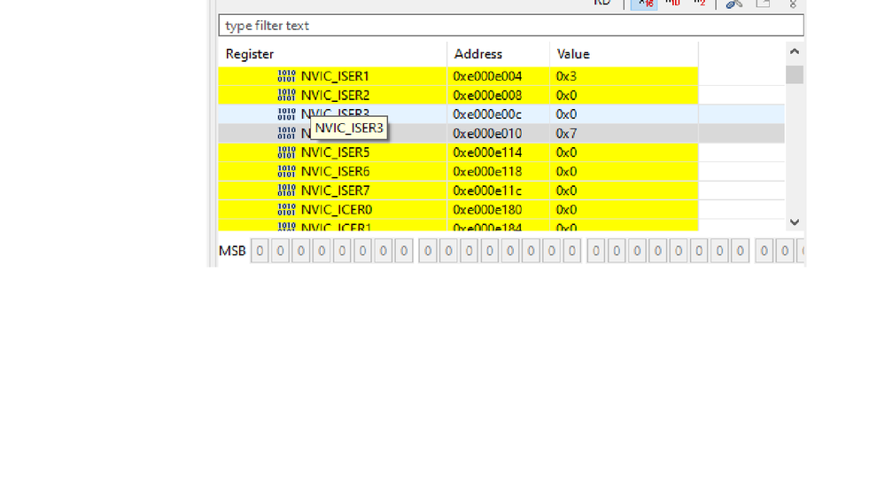

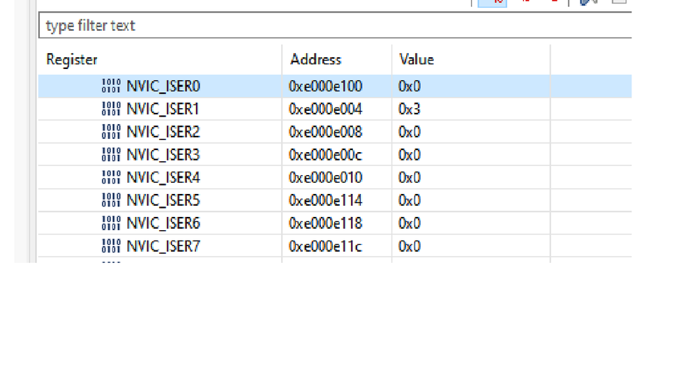

Yeah I copied correct file only. I checked the SVD file. Only ISER0, ISER1 and ISER2 are there. Others are not there. I also tried adding them manually. Still I see the same issue.
ISER0 -> 0xE000E100 .this is correct
but ISER1-4 are not correct here.
ISER1-> 0xE000E004
ISER2-> 0xE000E008
ISER3-> 0xE000E00C
ISER4-> 0xE000E010
Those should be 0xE000E104, 0xE000E108, 0xE000E10C and 0xE000E110 respectively

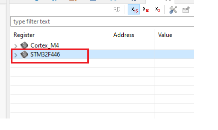

Hi @PK​,
Thanks for bringing to attention. I think there may be multiple issues here.
The NVIC register is described both in the CORE svd-file and the device specific svd-file.
To explain: The SFR-view loads two svd-files. One for the core itself and one for the specific STM32 product describing its peripherals. See below each top-node represents an svd-file:
I think you checked the NVIC node inside the STM32F446 parent? Check inside the Cortex_M4 instead.
I think it is a bug if the device specific file contains NVIC node as well. But I have to check internally. The same files are delivered for CubeIDE that are used for IAR and Keil. And if IAR/Keil dont load two svd-files, then I can understand if there is a need for information duplication. I am no expert on those external tools, but will check...
Will also ask svd-file team to check if the ISERx registers are on the correct addresses regardless of which svd-file. Looks like there may be issues in this aspect as well.

I got some temporary solution. Instead of checking the NVIC register in Cortex_M4 check into the microcontroller specific NVIC section. There the addresses are correct.
Ex. In my case:
0693W00000Bc6tqQAB.pngI see the below addresses which are correct. but here all the registers are not available

I found all mine .svd file from command prompt:
open cmd and excute this command: C:\>where /r c: "*.svd"
and Then you will see there is svd files:
C:\Program Files\STMicroelectronics\STM32Cube\STM32CubeProgrammer\SVD\Cores\Cortex-M0plus.svd
C:\Program Files\STMicroelectronics\STM32Cube\STM32CubeProgrammer\SVD\Cores\Cortex-M3.svd
C:\Program Files\STMicroelectronics\STM32Cube\STM32CubeProgrammer\SVD\Cores\Cortex-M33.svd
C:\Program Files\STMicroelectronics\STM32Cube\STM32CubeProgrammer\SVD\Cores\Cortex-M4.svd
C:\Program Files\STMicroelectronics\STM32Cube\STM32CubeProgrammer\SVD\Cores\Cortex-M7.svd
**I just opened Cortex-M4.svd file and searched NVIC ISER0 and ISER1 . I saw offset address are wrong "<addressOffset>0xFC</addressOffset>"
I changed it and ı debuged my code and I opened NVIC registers MAP. But guys over there you will see a tools change. U need use your customer svd file as a this file
where it is "C:\Program Files\STMicroelectronics\STM32Cube\STM32CubeProgrammer\SVD\Cores\Cortex-M4.svd"
here is how I changed:
