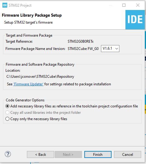

We have an older Cube project from a STM32F0 series that needs to be changed to the larger STM32G0B0 chip. We thought that we would just create a new project with the new micro and port in the older code. When we create the new project there does not appear anywhere in the selection process to have it use the Low Level drivers instead of the HAL.
  • Start New STM32 Project
  • Under MCU/MPU selector, Select STM32G0B0RET6
  • Nothing in this tab has anything to do with LL drivers.
  • Select Next.
  • Name Project, C++ Target Language and STM23Cube Project Type.
  • Select Next.
  • Select 1.6.1 Firmware package.
  • Code Generation Options does not show anything about HAL or LL drivers.
  • Select Finish.
A project has been created where the Drivers directoy has a STM32G0xx_HAL_Drivers directory.

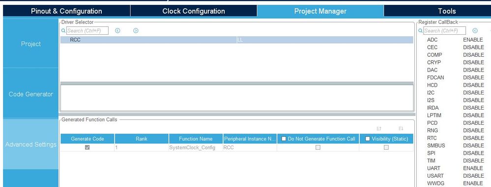

Open the .ioc file by double clicking at STM32CubeIDE and then select project manager -> Advanced settings. There is driver selctor- list where can select HAL or LL driver for each activated MCU block.

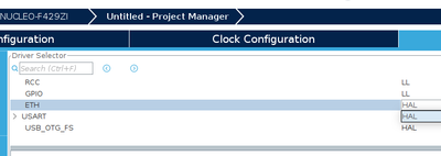

There doesn't seem to be a LL option for peripheral ETH on the NUCLEO-F429ZI
cube 6.11.0
Right. For some complex drivers, like USB, ETH ...there is no LL driver existing - as you can see.
