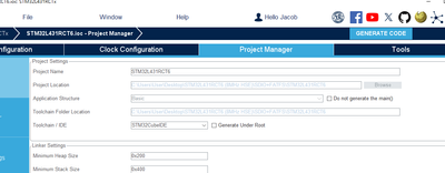

Jacob3104
But my MDK-ARM project based on STM32CubeMX (.ioc file)
In this case, I think you should start the project from the .ioc file in this case.
Also, I may suggest you regenerate the project from CubeMX with IDE as a toolchain and unchecking the "Generate under root". This way any user code in the main.c will be kept (not sure about other files added by users).
Best Regards.
STTwo-32

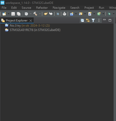

Jacob3104
i start the project from the .ioc file and also regenerate the project from CubeMX with IDE as a toolchain and unchecking the "Generate under root".
But after i generated, the project does not have anything.

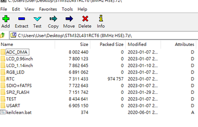

Jacob3104
This is the original file (SDIO+FATS) one, i want to import it.
