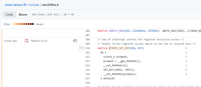

I've compared the F4 project with the F0 project:
             In the F4 project the ATOMIC macros are included in stm32f4xx.h
            In the F0 project the ATOMIC macros do not exist in stm32f0xx.h
It seems that the HAL code for the UART is calling macros that don't exist.
They exist right here and have for 4 years.
Maybe you're using an outdated version. Super old project?

The issue that I had was that I had v1.11.0 installed, this is still on the ST download page, but this version does not have the macros. You need to have the patch (1.11.5) installed, its not obvious if that patch is missing because it gets installed in the v1.11.0 folder so you do need to check the release notes.
The previous answer was enough to point me in the right direction.
