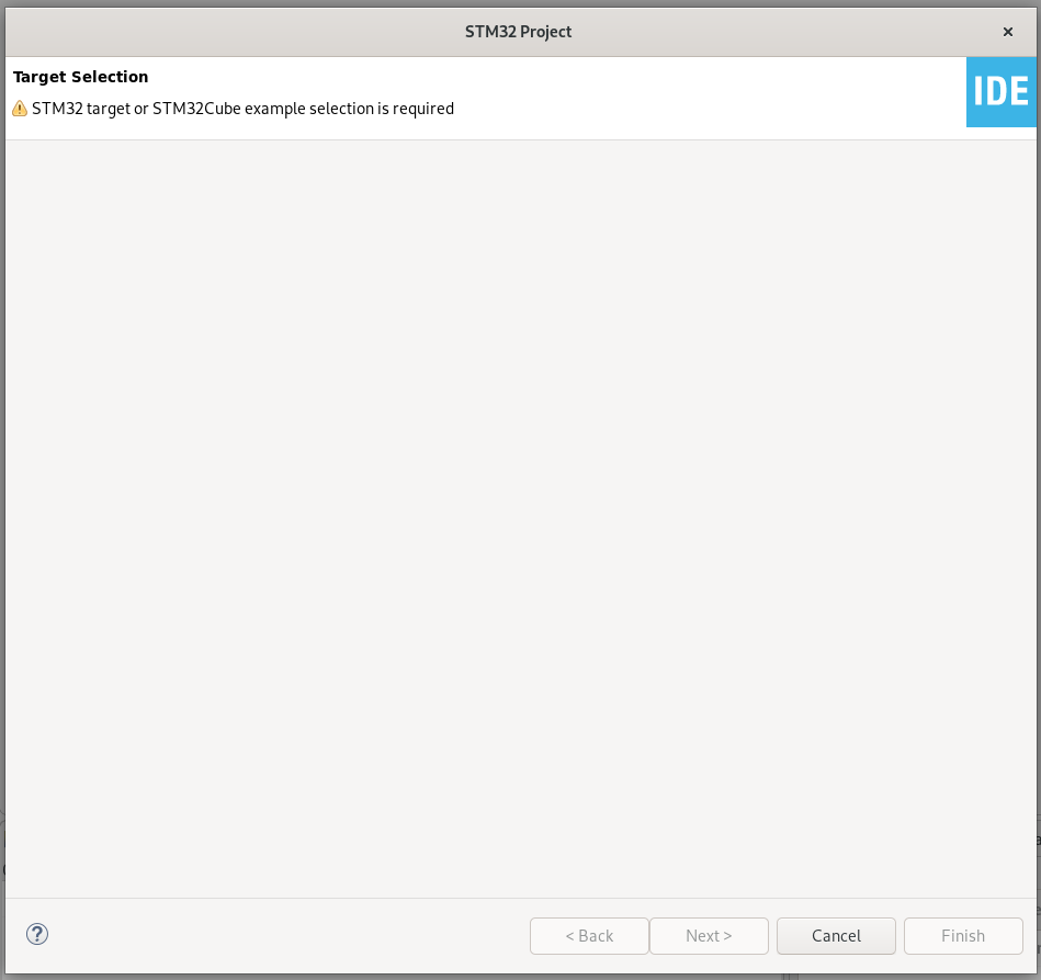

Have installed STM32CubeIDE on my Debian Linux system.
Following the QuickStart Guide, I try: File > New > STM32 Project
and it thinks about it and the gives me:-
0693W0000059g6TQAQ.pngWhat did I forget to do and where does it tell me to do it?

That's the page to select a chip, which you need to do. Maybe you need to resize the window or something to see the options.

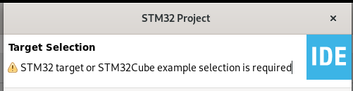

PJR42
Sorry, I cropped the screenshot to just show the message.

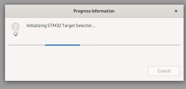

This is the sequence of events after File > New > STM32 Project:
First it appears to be doing something ...
Then the Target Selection windows opens, empty ...
I have checked out Installation to Project instructions and walk-through videos and they all show this last window fully populated.
Luckily, I haven't invested in any hardware yet ;)

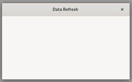

Also noticed and it may be related.
If I select Help > Check for Target Selector Device Database Updates,
I get this:
0693W0000059jbhQAA.png Which just sits there until I get bored and close it.

You do need to be connected to the internet as downloads some packages, at least the first time you run it. If you're behind a proxy, it probably won't work out of the box. If that's not it, I'm not sure.

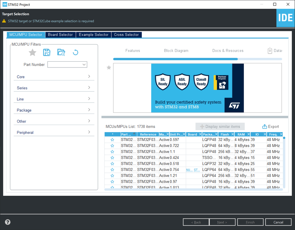

As for standalone STM32CubeMX:
Downloaded and installed it and it does not show the problem, neither does it cure it in STM32CubeIDE.
If it actually works, I went no further than checking the Target Selector, then I suppose it could be a workaround albeit rather clumsy ...
