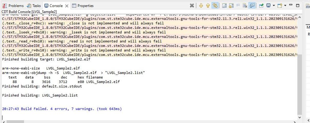

Hi Folks,
I don't know what I did but the IDE is giving me a error message that I've never seen before. Here's a screen capture of the messages. It's saying that "_close is not implemented and will always fail". Is there a Project|Properties that I need to change? Thanks, Richard

‎2023-10-04 12:49 AM
The question has already been discussed a few times in the community, e.g. here, where HBoss.1 has shown a very simple solution.
Hope that helps?

‎2023-10-04 9:35 AM
Thanks Peter,
So, if I'm reading the proposed solution correctly, I'll need to step back to version 1.13.1. Currently I'm running 1.13.2.
So I should step back to 1.13.1?
Thanks again,
Richard
‎2023-10-04 9:53 AM
Peter,
I went ahead and stepped back to 1.13.1 and I have the same issue. I get the same 4 error messages.
You wouldn't have a plan B would you?
Thanks again,
Richard
‎2023-10-05 12:23 AM
No, you don't have to (and shouldn't) go back to an old version. As I said, someone in the thread mentioned above has already found a solution (the one I mentioned before also works, but does not eliminate the cause):
- create a new project with 1.13.1 (or the most recent version of STM32CubeIDE)
- grab the files syscalls.c and sysmem.c from Core/Src
- add those files to your existing project
Regards
/Peter
