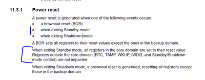

as stated in Reference manual :

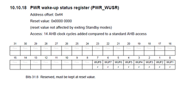

for WKUP pin you can read the following status register :
but be careful to the configuration because this can be cleared automatically by hw. and be careful to read the value before some initialization, You have to check from which power reset you get up.
For RTC : if you select stand by with RTC (obviously you do) the the registers values are backed up in standby mode. So you should retrieve the interrupt that wakeup into the RTC status register.
