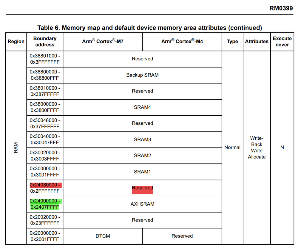

i am currently porting an existing project from stm32h757 to stm32h747.
i have created a new cubemx project for the stm32h747 and copied all details from the original project (please note the cube version is the same). also, i have copied the .icf files.
after generating the new project i tried to compile (for the M7 core) and recieved a link error:
Error[Lp011]: section placement failed
unable to allocate space for sections/blocks with a total estimated minimum size of 0x8'1abc bytes (max align 0x8) in <[0x2400'0000-0x2407'ffff]> (total uncommitted space 0x8'0000).
after increasing the RAM this was solved, but now i am uncomfortable to go foward because i do not understand the problem, how did this happen from the same cube config.

You cannot extend AXI SRAM memory size as it is mentioned in the memory map.

i am actually able to increase the size of that section but as i understand from you this can resolve in unexpected behavior? could you tell me what this could cause?
regarding the optimization, it is completely disabled.
also, i dont understand why this does not work on the STM32H747 when the on the STM32H757 it works perfectly, the addresses are the same and the cube generated project is also the same...

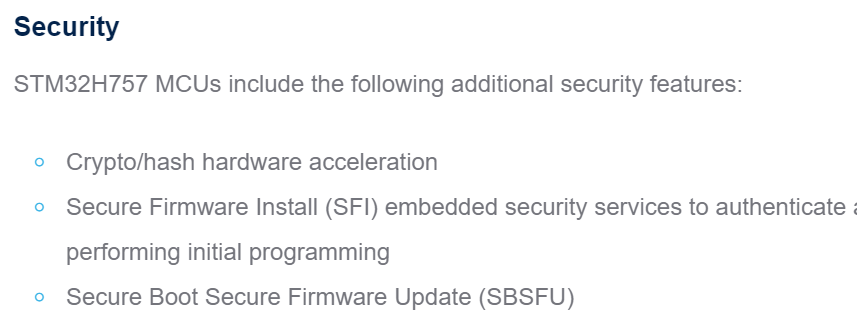

Didn't compare both datasheet, I will assume the memory map is the same between the two chips, only the crypto related IPs are missing in the H747.
