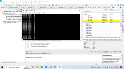

I want to count the pulses coming from COMP2's output using LPTIM1. However, when I send it to Tera Term, the displayed LPTIM value is consistently 1, and it doesn't match the COMP2 output.
Has anyone had this problem? How did you resolve it?
I would greatly appreciate it if there is an expert who can assist in fixing this issue.
I am using STM32Cube IDE Version: 1.10.1.
My MCU is STM32L051C8T, on a custom board
This is my clock
This my LPTIM configuration
this COMP configuration
this my code

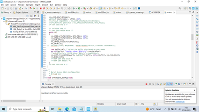

  /* USER CODE BEGIN 2 */
  HAL_COMP_Start(&hcomp2);
  uint32_t counterValue = HAL_LPTIM_ReadCounter(&hlptim1);
  //sprintf((char*) aMsgBuffer, "Batas deteksi:%d\r\n",counterValue);
  //HAL_UART_Transmit(&hlpuart1, aMsgBuffer, TXBUFFERSIZE(aMsgBuffer),0xFFFF);
  //HAL_UART_Transmit(&hlpuart1, "dua", 10, 1000);
  /* USER CODE END 2 */
  /* Infinite loop */
  /* USER CODE BEGIN WHILE */
  while (1)
HAL_GPIO_WritePin(GPIOA, GPIO_PIN_3, SET);
HAL_GPIO_WritePin(GPIOA, GPIO_PIN_1, SET);
LC_Init_GPIO();
// sprintf((char*) aMsgBuffer, "Batas deteksi:%d\r\n",LcSensor1.CountDetect);
// HAL_UART_Transmit(&hlpuart1, aMsgBuffer, TXBUFFERSIZE(aMsgBuffer),0xFFFF);
char buffer[50]; // Adjust the buffer size based on your needs
sprintf(buffer, "counter value: %3lu\r\n", counterValue);
HAL_UART_Transmit(&hlpuart1, (uint8_t*) buffer, strlen(buffer), HAL_MAX_DELAY);
  HAL_Delay(1000);
//sprintf(buffer, "counter value: %lu\r\n", counterValue);
//HAL_UART_Transmit(&hlpuart1, (uint8_t*) buffer, strlen(buffer), HAL_MAX_DELAY);

But why my counter value displayed in the serial terminal remains 1, do you know it
This is my code
waclawek.jan
Where do you change the counterValue variable?
Do you mean my variable is on line 107
waclawek.jan
Yes. You don't change it in the while() loop.
