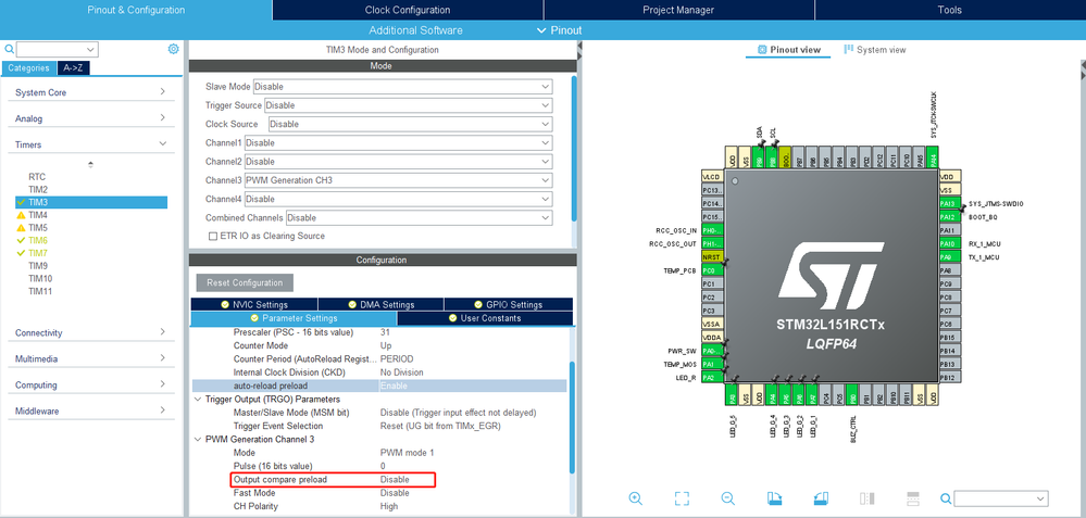

LL library STM32 OUTPUT compare preload pwm setting enable is unsuccessful,May I ask what is the reason?
2020-05-14 3:47 AM

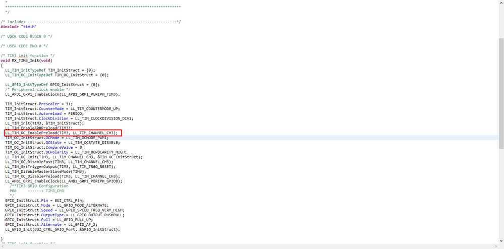

When I set Output compare preload to enable in the configuration interface, the generated code shows disable
- Labels:

Look 2 lines higher than is the highlight - there's the preload enable.

Thank you for your answer. When I set Out put compare preload to disable in Device Configuration Tool, the highlight is still enable. I do n’t know how to configure to change these parameters. Could you tell me if you know?
2020-05-14 8:32 PM
My IDE version is 1.3.0

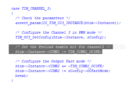

Hello @Bence
The LL are a translation of the intropack HAL drive. So, if in the function of the driver that you call there is a forcing of this parameter, then it appears in the LL code generation.
In the reference function you would call (if you are in HAL):
HAL_StatusTypeDef HAL_TIM_PWM_ConfigChannel(TIM_HandleTypeDef *htim,
TIM_OC_InitTypeDef *sConfig,
uint32_t Channel)
There's a call for channel preload.
This is the code you find in LL.
Best regards,
Nesrine
2020-05-15 12:52 PM
Hi @Nesrine.JLASSI
Why is then an option in the GUI to enable the preload, if it is ignored?
