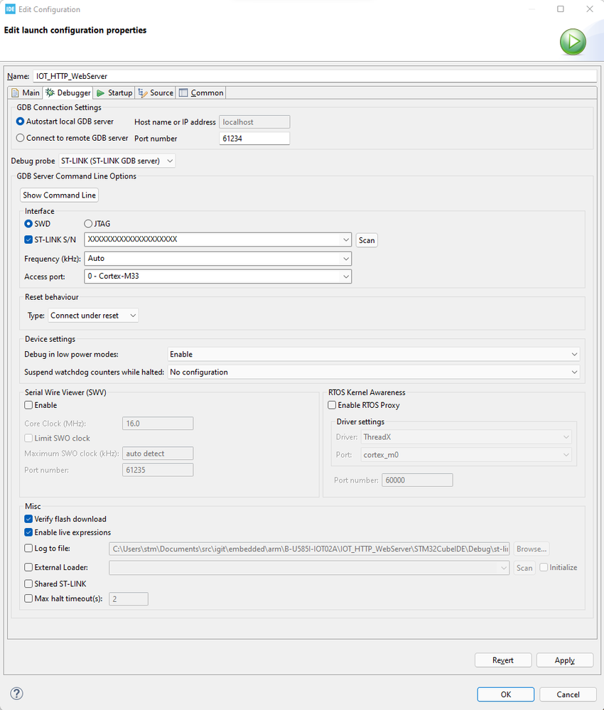

So assuming that this should work I tried to run or debug the IOT_HTTP_WebServer application by right-clicking the project in STM32CubeIDE Project Explorer and selecting "Debug as..." -> "STM32 Cortex-M C/C++ Application". In the "Edit launch configuration properties" dialog that pops up I leave all the default settings:
0693W00000LxiUgQAJ.pngI can click on the ST-LINK S/N check box and click "Scan", and a serial number appears, so the connection appears to be working. I replaced the serial numbers manually with XXXXXX only for the screen shot.
When I then click ok I can see the the red LED next to the CN8 USB connector on the board flashes twice in green, and then an error message pops up with the text:
Error in final launch sequence:
Failed to start GDB server
Error in initializing ST-LINK device.
Reason: (0) Unknown. Please check power and cabling to target.
And in the Console view I see the following:

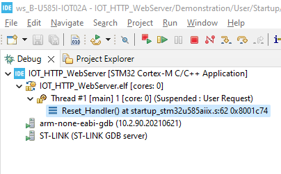

stm7321
Hi Laurent,
thanks for trying it out and confirming that it should work the way I thought.
After your reply I retried it, and after many more attempts I finally found out that I had caused the problem myself. When I start the Debug session, in the console view I get the message "Waiting for debugger connection" and while the program is uploaded the debugger shows that the program is suspended in the "Reset_Handler" function:
0693W00000LxmMlQAJ.pngI always pressed the "Resume (F8)" button because I had thought that the program should continue until it is actually supposed to stop in the "main()" function, but exactly this caused the error in the debugger launch sequence. If I don't press the "Resume (F8)" button and simply wait, then after the program is successfully uploaded the program resumes automatically. Then it stops at the HAL_Init() function in main, and everything works as expected.
Thank you
Stephan
2 REPLIES 2
LaurentL
You're are correct, CN8 is the USB connector for debugging. It is marked STLK as for STLink.
You don't need to specify the STLink Serial Number if you have only one board connected.
It is useful only if you have several STLink connected to your computer.
I tried to import this same example and I could debug it without issue with STLink gdb server or Openocd in version 1.9.0 on Windows 10.
I didn't change any debug settings.
The debug starts and is halted in HAL_Init() function in main.
Then, you can step or continue.
You can read the STM32CubeIde User Guide first.
Available in Help => Information center.
Then in "Read STM32CubeIde documentation"
If you need only to update your program, you can use a Run configuration that will only program the application.(or use STM32CubeProgrammer as you did).
If you need to debug the application, use a Debug configuration.
