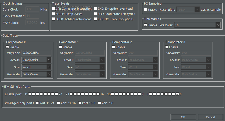

I am successfully using all the SWV debugging functionality in STM32CubeIDE except for the ITM functionality, as described in UM1609 and in the advanced debugging videos on youtube from ST.
I have both tried overriding the "_write " function in main.cpp or replacing "__IO_putchar" with "ITM_SendChar" in syscalls.c, but I don't see any output when using printf and ITM port 0 (described in video 4 and section 4.3.5 in UM1609).
I have further tested sending output to ITM port 31, as described in video 5, but still cannot see any output.
Some details and further questions
  • SWO is left unconnected - Do I need to connect the SWO to some other pin to make ITM work?
  • I am running at 180 MHz clock speed - Is this too fast for ITM?
  • Does it matter if I compile for cpp rather than c?
  • Are there any benefits to updating an ITM port, like in video 5, rather than updating a global variable and observing the execution order by looking at a graph in a SWV Data Trace Timeline Graph or in CubeMonitor?
  • Any further suggestions of why I can make all but ITM work for me with Nucleo-F446RE?

I have tried ruling out a few things by copying the code from the youtube ST advanced debugging video series:
  • I am running at 180 MHz clock speed - Is this too fast for ITM? I have tried setting this now to default 84 MHz, like in the video, but I get no difference. Edit: I forgot to include the _write function and it was working at 84 MHz.
  • Does it matter if I compile for cpp rather than c? Not working for C either.
The advanced debugging capabilities in STM32CubeIDE is really impressive if i can make it work. Can someone test the ITM functionality on a different MCU or board? Preferably on a M4.

Andre_k
April 10, 2024
Updating to the ST-Link current latest version 3.14.5 fixed the issue for me. Try that first before attempting to downgrade your ST-Link. I have testet this with an STM32G491RE-Nucleo and STM32CubeIDE version 1.15.
Hope this helps :)
Edit: Clock speed should not be an issue, I have testet it at 170MHz. The clock is anyway prescaled down as shown in the upper left under "Clock Settings".

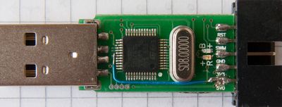

This one found later is very complete and specific to STM32Cube, shows the soldering too:
https://www.phippselectronics.com/debug-an-stm32-with-printf-using-only-an-st-link/?srsltid=AfmBOorCxzUAUEuBmm9tu8dBFsDcoqrF5useMoWPx1Xr0boK0YVY9dgK
HARDWARE SETUP:
A STM32 board + ST LINK v2 clone
I used the Chinese Clone, followed this tutorial to solder the PA10 pin == SWO pin to a wire than THEN is to be connected to your STM32's PB3 pin which is the SWO to USB Virtual Com Port VCP connection, basically where the ITM_SendChar() usart function is sending its serial data to.
Note: Soldering it is not impossible but actually quite hard, took me about 90 minutes of soldering with my thinnest soldering tip, then find my thinest wire, and solder under the phone in macro mode, did not have a magnifier, to see what I was doing.
Pretty much the smallest solder I've ever done. But well it worked.
Tutorial here to jhelp with the soldering and locating the pin.
Location: 6th pin from the bottom of the picture, 7th pin from the top end of the picture.
It is a tiny tiny pin and soldering takes patience... I did it im no solder expert, got basic iron, did not use a binocular but if you have one use it, or else use the phone in macro mode and use a coffee mug or piece of wood to hang the phone then work underneath it. USE the MACRO mode on you phone, much better definition image close in macro than zooming in in normal mode.
https://lujji.github.io/blog/stlink-clone-trace/
However the tutorial is not instructing you that the T-SWO pin / PA10 / pin 32 on ST Link v2 needs to be connected then to your PB3 (by default) pin on STM32F411, as this is the default for SWO, this tutorial mentions it:

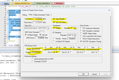

3. Setup your IDE. in this case Keil IDE with the following Trace setup:
- Speed 16MHZ for my STM32f411CE it worked. I believe the speed however is not essential. check your system clock speed by checking the SystemCoreClock  variable.
- What is essential is to ENABLE the Trace.
- Check to use the Core clockb
- ESSENTIAL : Select ALL of the ITM stimulus bits 0 to 31. In the past I used only 0 as recommended by many tutotials: DID NOT WORK ! Figured out it was the element that prevented the whole thing to work ! so set it to 0xFFFFFFFF
- Finally set the privilege mask to 0x00000008.
Note others report using only bit 0 stimulus 0x00000001 and then privilege 0x00000000.
Try both !
Screenshot of important values below: Essential value in Yellow.

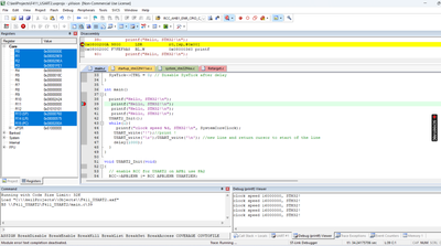

int main()
 printf("Hello, STM32!\n");
	USART2_Init();
	while(1){
		delay(1000);

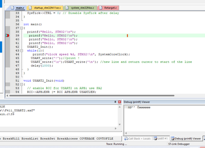

Ok so now you have done the 1. soldering of SWO on your ST link v2 clone, you have connected it to your STM32 PB3 SWO pin, but then you have no clue as to is it gonna work or why is it not ?
And my word this is where all the tutorials I found thus far were coming short : not telling you anything about testing, and diagnostic of 1. the HW connections then the 2.software
Showing the system clock using SystemCoreClock here:
HOW DO YOU TEST that the SWO Connection is working ?
As below highlighted in REd the ST link v2 clone SWO / PA10/31 pin to SWO/ PB3 on STM32F411 connection, it is breakable : 2 parts wire.
Note: no need to connect it through the header of the St link clone, it is another risky, risk of damaging the clone for no reasons, when you can just add a new wire like i did 1. simpler 2.faster 3. does not force you to sacrifice one of the existing header pins and connection.
This test is missing from ALL the tutorial I found !
- Once you have configured your IDE (as below) and printf() redefinition (as below) , then EVEN if your settings e.g. TRACE Clock wrong or ITM Stimulus bits are wrong, You will still see data coming through to the Debug window SWV viewer window in Keil or Cube IDE.
It will not print meaningful ASCII Chars, only incoherent characters but you will see the data incoming, and can switch to HEX view mode to check that data is sent.
Wrong chars but data coming yay !
if the speed of your clock is too fast it might fail without showing anything due to being unable to sync with viewer. So my advice on testing clock speeds: Start with the lowest to the greatest e.g.
// 100 96 84 80 50 48 32 24 25 16 MHZ. =>> 16, then 25, then ... lowest first.
So TEST: in the while(1) loop in your main: add endless printf(xxx) statements until you see something.
This is the VERY FIRST KEY step, that is not explained anywhere pretty much, that I figured out of luck and a tiny bit of experience debugging sh**ty stuff.
ADDITIONAL TEST, very helpful BREAK THE SWO WIRE ON AND OFF see what happens !: I set up a breakable wire in 2 parts, that I played with to disconnect while running the Keil IDE SWV debug trace viewer and indeed when disconnecting it the data stopped coming immediately on the viewer and then resumed instantly once reconnected.
So yes these 2 Hardware test steps, testing that your SWO pin is spitting data out, is the very first thing.
