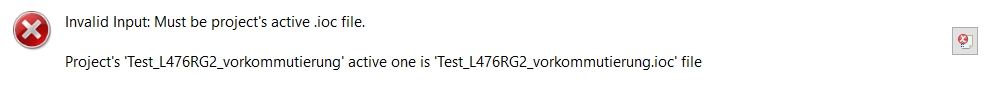

Invalid Input: Must be project's active .ioc file.
i want to clone my project. I did the following steps:
1) Edit > Copy.
2) Edit > Paste.
3) Rename the ioc files.
4) Delete the Debug.launch file.
5) Project > Clean.
the next step is to generate the CubeMX. But when I try to open the .ioc file this error message occurs:
can anybody help me please?

    The name of the project is also in the IOC itself (a normal text file) under the item ProjectManager.ProjectFileName and must also be changed. However, since the IOC should not actually be changed manually, care must be taken not to damage the IOC structure.

    Yes I want to clone the project. I copy and paste the entire project folder in STM32CubeIDE. I renamed the project folder and the .ioc file to the same name. After this I deleted the Debug.launch file and cleaned my project. For the next step to clone the project I have to generate the CubeMX. For this step I have to open the .ioc file but this error message occurs:

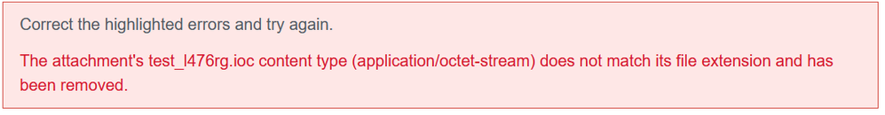

    Hi Peter,
    I am not able to attach the .ioc file (see the attached error message)
    Peter BENSCH
    Jul 13, 2023 10:25 AM UTC
    OK, we need to check again why IOC files are blocked. As an interim measure, could you please try renaming the IOC file to *.IOC.TXT?

    Your project is still based on CubeMX 6.8.0, 6.9.0 has been available for a few days, additonally you are using the old L4 firmware 1.7.2.
    But OK, that probably doesn't matter much at the moment. So I have:
    • created the directory Test_L476RG in the workspace, put IOC there
    • imported the IOC into STM32CubeIDE 1.3.0, not migrating to the latest firmware
    • opened IOC and made a temporary change to the IOC with CubeMX, saved, undid, finally saved = IOC is saved in current CubeMX structure
    • CubeMX window closed
    • in the Project Explorer on the left, copy the project and paste it as a copy
    • IOC of the copy renamed to name of the copied project
    • then open this copied IOC
    Everything is fine and as expected.
    Please try to install the latest STM32CubeIDE (can be installed parallel to the old one, but of course in a separate directory) and try again.

    I opened the project with the newest STM32CubeIDE and migrated it to the newest firmware.
    It works and I can open the .IOC file now after copy and paste the project.
    Thanks for your help Peter!
