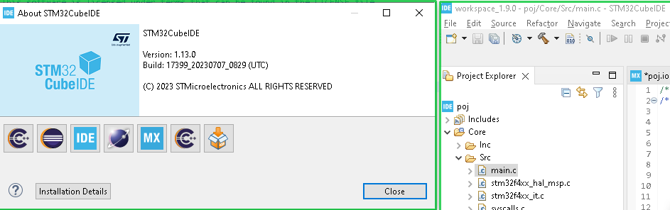

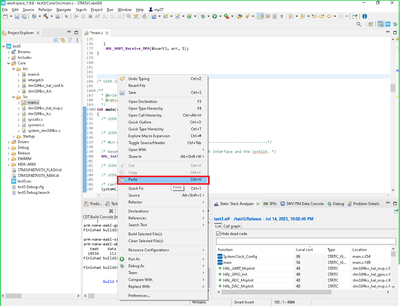

I need to copy text from internet to Cube IDE main.c file.
I copied the text from the internet, I click in the Cube IDE context menu "paste".
And nothing happens.
If I copy text from Cube IDE and paste that text into Cube IDE, then the text is pasted.
I tried to copy text from the Internet first to a text editor, and then to Cube IDE, but still no text is pasted.
Cube IDE restarted.
If I create a new Source File C and try to insert into it, then nothing is inserted into it.
(If I copy something from the Internet to this Source File.)
What's the matter?
Nothing can be copied from Cube IDE either.
I'm trying to copy text from Cube IDE and paste this text into notepad.
It won't work.

‎2023-07-14 5:02 PM
I found the reason.
My firewall was blocking some process intended for Cube IDE.
Since the Cube IDE was recently updated, the firewall blocked the process that it did not like.
Cube IDE started, but did not work correctly due to a blocked process.
Thanks to all)
