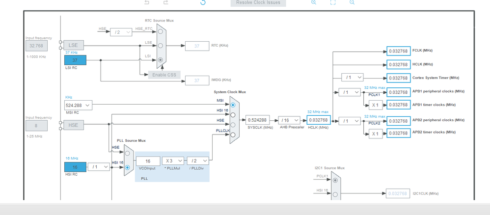

internal msi 32.768mhz not work when configurate with stm32cubeide.
jdo

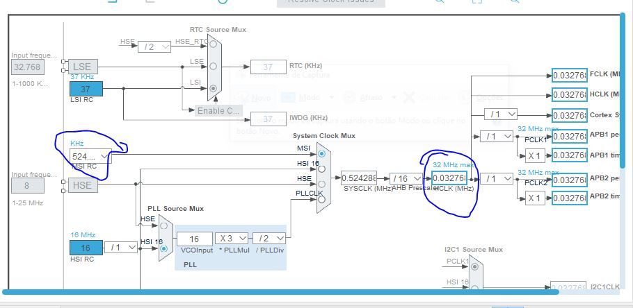

i am using stm32l010f4, i do a test with internal frecuency, why i need use 32.768mhz, but i don´t have external clock on pcb, i do a test with msi rc 524.288 khz, SYSCLK(MHZ): 0.524288, AHB PRESCALER (Here i configure with 512 and compile, i test and the clock work,so i decre the AHB prescaler in 16 and i test and the clock not work.
4 REPLIES 4
Javier1
Principal
Did you mean stm32cubeMx?
For the rest of your questionj im really struggling to understand anything at all.
Try to reformulate, maybe google translate your native languaje to english
hit me up in https://www.linkedin.com/in/javiermu%C3%B1oz/
jdo

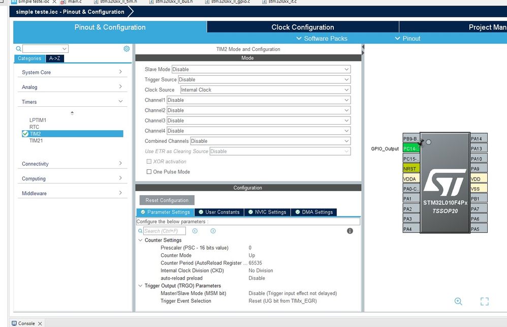

thanks for replying, i am configuring with .ioc using stm32cubeide. now i got the clock to work with 32.768khz, but when i enable timer 2, and compile i test again, then the c

  TIM_InitStruct.Prescaler = 0;
  TIM_InitStruct.CounterMode = LL_TIM_COUNTERMODE_UP;
  TIM_InitStruct.Autoreload = 65535;
  TIM_InitStruct.ClockDivision = LL_TIM_CLOCKDIVISION_DIV1;
  LL_TIM_Init(TIM2, &TIM_InitStruct);
  LL_TIM_DisableARRPreload(TIM2);
  LL_TIM_SetClockSource(TIM2, LL_TIM_CLOCKSOURCE_INTERNAL);

lock doesn't work anymore.
"I am setting up the clock for 32.768kHz, but when I compile and test it, it doesn't work. I place a simple counter in the while loop, but it doesn't increment."
my code is:
