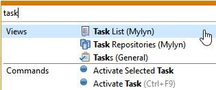

Thanks Markus. I have looked through there already and didn't get a resolution, so I came here. I suppose what I'd like to know is how far from 'standard' Eclipse that CubeIDE is, ie, can I expect plugins to work identically to standard Eclipse? If not, then this issue reset with ST, not Mylyn. If it should be basically a standard release, then the issue may be with Eclipse/Mylyn and I'd be querying those forums.

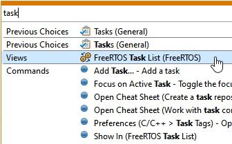

I'm not seeing Task List in the Quick Actions list; I wonder if FreeRTOS Task List is obscuring it? Just a theory.
On vanilla Eclipse it looks like this:

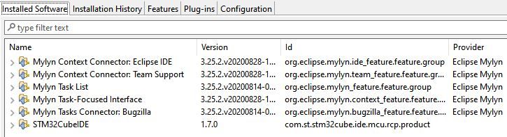

This is the installation I'm using.

I have not resolved this yet but using the Eclipse .log file I have been able to find more info, and links to others who have also encountered this. e.g.,
https://bugs.eclipse.org/bugs/show_bug.cgi?id=569078
Seems to be some dependency conflict with com.sun.xml.bind 2.2.0 vs 2.3.3
If I get a workaround I'll post, otherwise please someone help out here; I'm hacking into things I am not familiar with.
