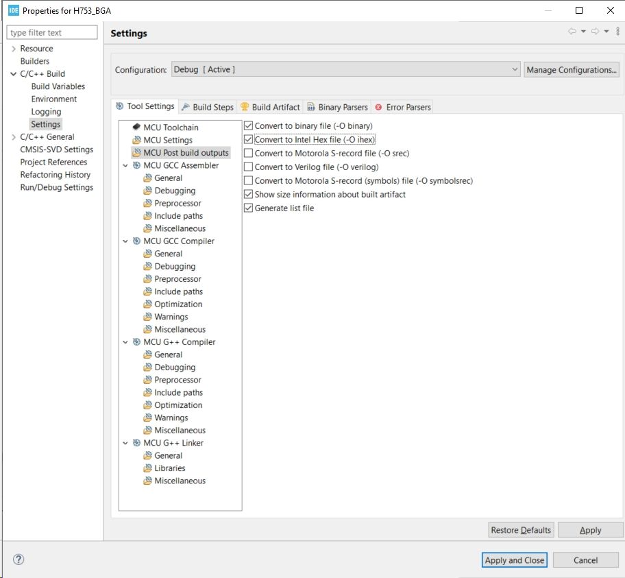

How does one generate a .hex file from STM32CubeIDE?
  • March 17, 2020
  • 8 replies
  • 49978 views
... ideally automatically as part of a normal Debug or Release build.
Best answer by KnarfB
Project Properties > C/C++ Build > Settings > Build steps > Post-build steps > Command:
arm-none-eabi-objcopy -O ihex ${ProjName}.elf ${ProjName}.hex

SCobr.1
Visitor II
February 4, 2021
for google:
Project -> Properties -> C/C++ Build: Settings -> Tools Settings : MCU Post build outputs: "Convert to Intel Hex file (-O ihex)" 0693W000007E15DQAS.png

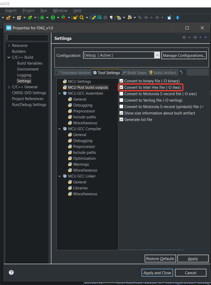

PR.4
July 5, 2021
PR.4
July 5, 2021
This works for me.
(STM32CubeIDE, Version: 1.6.1, Build: 9958_20210326_1446 (UTC))
