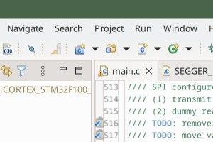

Beside this question like to be slightly outdated I found a neat solution to this issue.
I've the same problem when running STM32CubeIDE (Eclipse 4.23) under Linux on a 4k screen.
It's described here and seems to work: https://askubuntu.com/questions/777411/eclipse-neon-icon-size-in-ubuntu-16-04-hidpi
​So I've edited the ​/usr/share/applications/stm32cubeide.desktop by adding `GDK_DPI_SCALE=0.5 GDK_SCALE=2` to the line beginning with Exec=....
The full line is now
`​Exec=GDK_DPI_SCALE=0.5 GDK_SCALE=2 stm32cubeide %F`
The difference:
STM32CubeIDE on a 4k screen without any specific GDK settings
_legacyfs_online_stmicro_images_0693W00000bhl6FQAQ.pngThe same with modified GDK-settings:
_legacyfs_online_stmicro_images_0693W00000bhl6KQAQ.pngHope it helps if someone is searching for a solution.
BTW, the often mentioned solution `-Dswt.autoScale=175` or similar does NOT work. It only works on older Eclipse versions (prior 4.8?).
