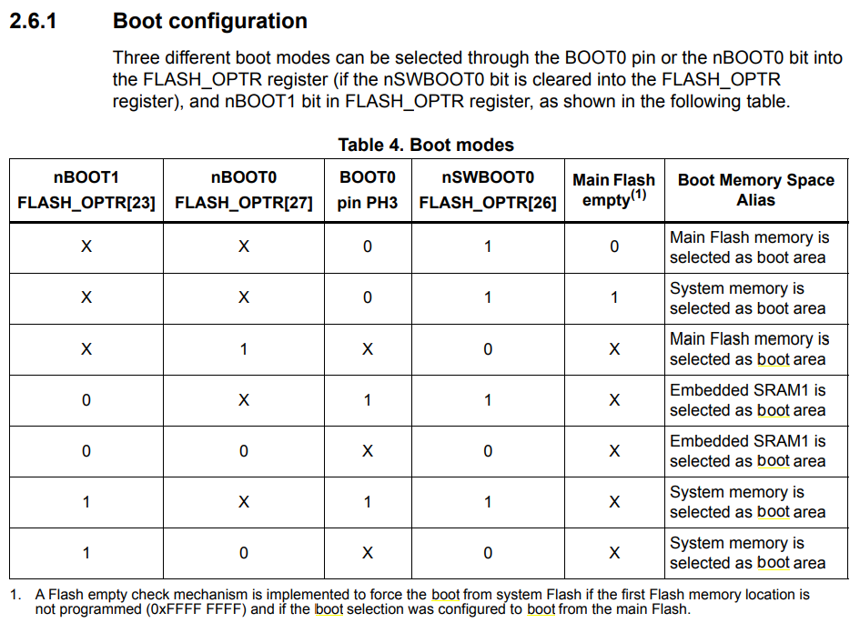

Hello @Kemaguco​ ,
What is your boot configuration? Check if it is well configured to run from flash.
Best regards,
@SBEN .2​

I just double checked the option bytes with the ST Link utility:
nBoot0_SW_Cfg is checked in the ST Link utility, and the tooltip tells me that if it is checked, BOOT0 is bonded to the PH3/BOOT0 GPIO, therefor the system is not using the BOOT0 user option bit but the BOOT0 pin (i.e. nSWBOOT0 is set in FLASH_OPTR).
Since it is a Nucleo board, I checked the schematic to ensure the BOOT0 pin was pulled down. I noticed that SB183 was placed so that the PH3/BOOT0 pin is pulled down to GND with a 10K resistor.
I also double checked if the main flash wasn't empty (as per your table), so I did a read of address 0x08000000 and distinctly observed non empty entries (in fact, the correct vector table was there, as expected).
Perhaps this is relevant, but I noticed that nBFB2 was not being selected in the options bytes. The tooltips tells me that Flash Bank2 would be used in that case. Since flash bank2 starts at 0x0810 0000 instead of the 0x0800 0000 the output of the compiler specifies, I checked nBFB2 in the options bytes and tried again, sadly without any different behavior. I'm also not sure how the device could've booted with nBFB2 unchecked in the first place, since the tooltip implies Bank 2 would've been used and that one was empty. If it has any relevance, DBANK is also selected in the ST Utility.
