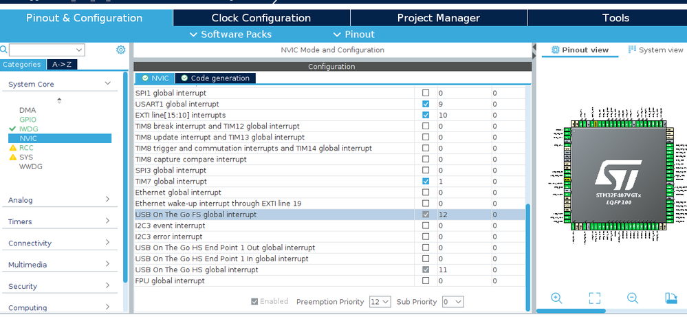

In which STM32CubeIDE project file are the USB OTG interrupt priority values?
RhSilicon
Lead
Hi, I'm testing the priorities of the modules, and I would like to know in which file the "Device Configuration Tool Code Generator" saved the NVIC definitions.
I have a lot of code outside the delimiters, I can't use the "Device Configuration Tool Code Generator", so I need to know which file is saved, and change manually.

6 REPLIES 6
Peter BENSCH

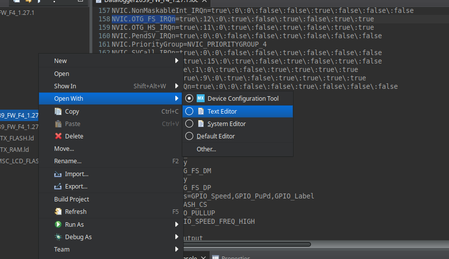

The NVIC definitions are stored in the IOC file, which is a text file, but you have to be very careful when modifying it so as not to destroy the structure. Since it is not intended for manual modification, there is also little documentation on the internal structure.
However, you will find the IRQ priority under NVIC.OTG_FS_IRQn.
Hope that helps?
Regards
/Peter
Thanks,
If the intention is not to be handled manually, how can I add delimiters in the code for the automatic generator to preserve my code?
RhSilicon
Lead
This is the last place I would look, I thought this file was read only by "Device Configuration Tool Code Generator"
RhSilicon
Lead
I closed the project, removed the *.ioc file and performed project cleanup, but it compiled with no errors. So there must be another file that has this priority data.
RhSilicon
Lead
Or is it not possible to change the priority and the "Device Configuration Tool Code Generator" shows this option just for decoration?
