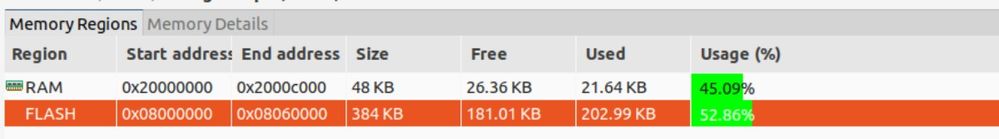

Besides, I have tried using STM32CubeProgrammer and even there the flash memory size is incorrect. Both platforms show that the flash memory size is 128 KBytes; I am using a STM32L152VD micro-controller. I have verified that the chip RDP is 0xAA (Level 0, no protection). For Openocd and ST-link GDB serve, I have tried different resent modes too.
In the Memory Regions tab, I have the following:
0693W00000DlrsHQAR.jpgSo, I do not know whether it is a code/program or a platform issue.
Thank you for your help.
Regards.
I have checked internally and the fix will be available on next STM32CubeProgrammer version 2.9.0.
As a workaround, you can fix the file in your current version :
File STM32CubeProgrammer_2_8_0\Data_Base\STM32_Prog_DB_0x436.xml
Replace :
<FlashSize address="0x1FF800CC" default="0x20000"/>
By
<FlashSize address="0x1FF800CC" default="0x60000"/>
For STM32CubeIde, same fix to apply on same file in STM32CubeProgrammer plugin.
For Openocd, did you try "software system reset" ?
If you didn't connect the STLink reset line to mcu's reset pin, you must use this reset strategy.
