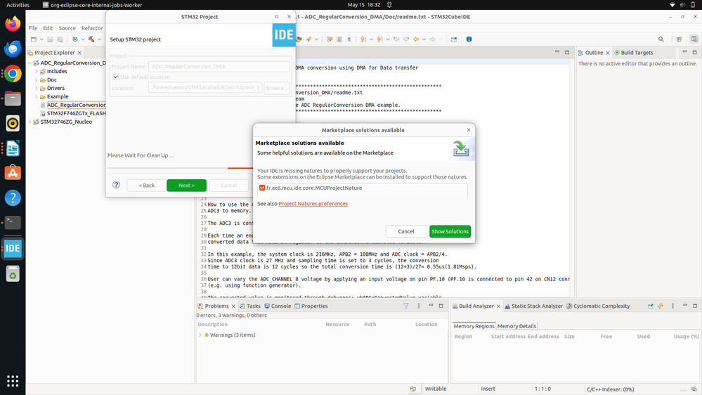

Unable to build and flash imported program in NUCLEO-F746ZG
shreya_awati
I got this error also.

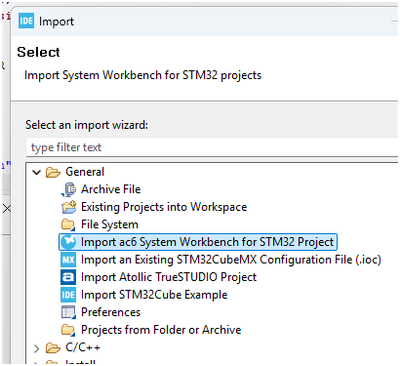

@shreya_awati It looks like your project is for another variant of Eclipse (SW4STM) so it needs to be converted to CubeIDE format. Try importing it as shown:

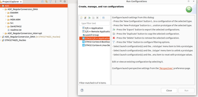

shreya_awati
same issue .

Have you tried to import ac6 System ... project from the SW4STM32 subdirectory? Was the import successful or any errors? Please attach .project files before and after import.

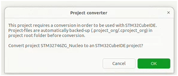

Can you please check steps of import. also in last sec you can see it shows to convert into IDE code but unable to see conversion option in stm.

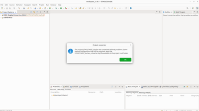

So you clicked OK here, and what happened?
Do you see these backup files in the folder? The conversion log?
.project files  . Where i can find this ? so i will share screenshot
Pavel A.
In Linux the dotted files are invisible ;) Do whatever is needed in the Linux browser (nautilus?) to make them visible. And please attach the converter.log.
