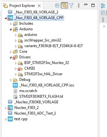

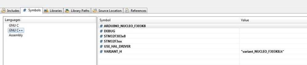

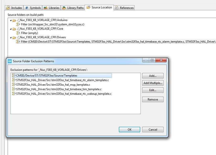

I have already spent hours trying to get the Arduino library working in my CubeIDE (1.12.0 IDE; latest STM32duino; Firmware F3 1.11.4). I set up all the include paths, and changed the arduino stuff, to point to the CubeIDE generated files.
I had some issues, that the Serial was not declared, but this could be fixxed, when i changed my user_man file to *.cpp. But now it says " undefined reference to `setup' ".

What has to be done in order to make it work?
