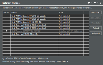

While you're waiting for reply from ST: have you seen the toolchain manager of CubeIDE ? Have you tried to fit that clang toolchain into the required tree structure (if it is not already)?
‎2023-06-23 4:59 AM - edited ‎2023-06-23 5:00 AM

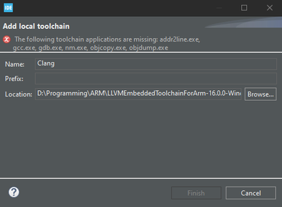

Hi @Pavel A. thanks for the reply. No, I've not seen any toolchain manager for CubeIDE unless you are referring to this:
Which doesn't support anything other than gcc due to the way the interface is designed to require a specific directory structure that matches the gcc toolchain. I did try and point it to the clang toolchain but it didn't work:
Thanks for the suggestion though.
