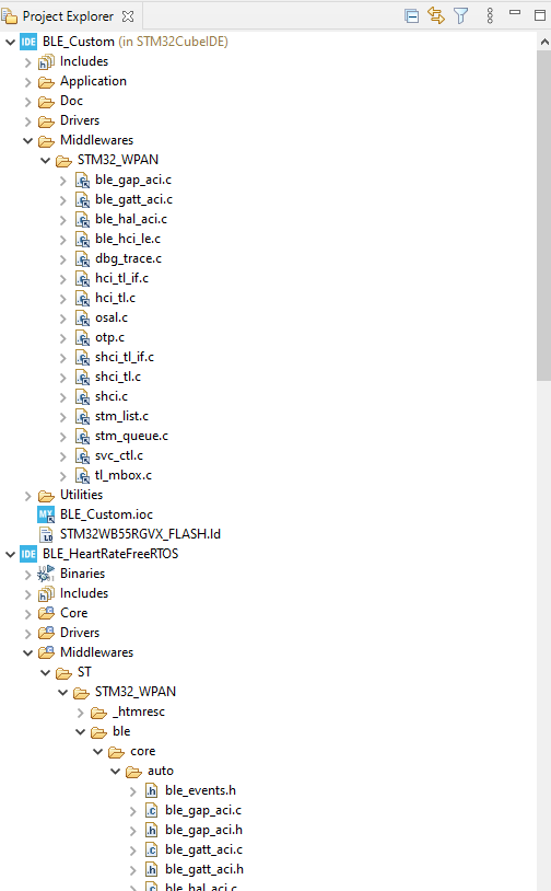

Using FreeRTOS heart rate example VS Custom sequencer example
Difference in middleware BLEfiles structure in CubeIDE .
Image attached.
The NO RTOS project shows all BLE files 'togehter' , without .h files
The RTOS project keeps them in the original file structure.
How can I see the .h files in IDE?
Is there a way to sync then to same view?

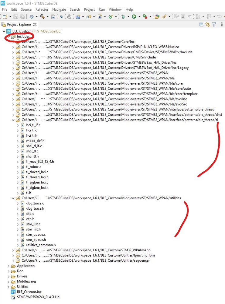

In general h-files are not listed as part of the example project in the .project-files. Therefore they are not visible in the project tree structure. h-file directories are typically only setup as include directories to the compiler. So, to me, this is "almost" working as expected...

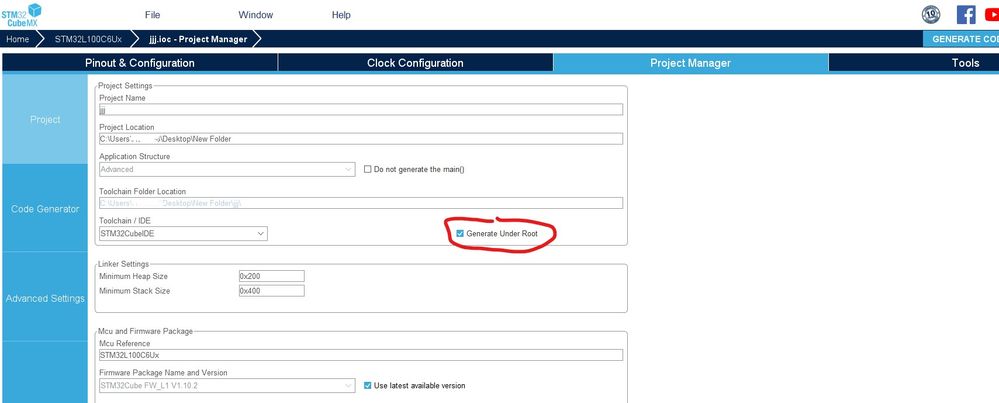

Most probably you have to take care to project root mode you're relying on.
STM32Cube example are so called 'non under root' (because sources are shared across multiple IDEs (IAR, Keil, STM32CubeIDE, ..))
If creating a project from scratch relying on STM32CubeMX you can select between 'non under root' or 'under root' mode
If creating a project from scratch relying on STM32CubeIDE no choice your project will be 'under root'
As 'under root' and 'non under root' structure are not same you cannot mix them. Initiating a project relying on one mode is final choice.
If example, 'non under root' mode so .h files are not part of project root so not "visible" by default if IDE project tree. You can access them thru include shortcuts
