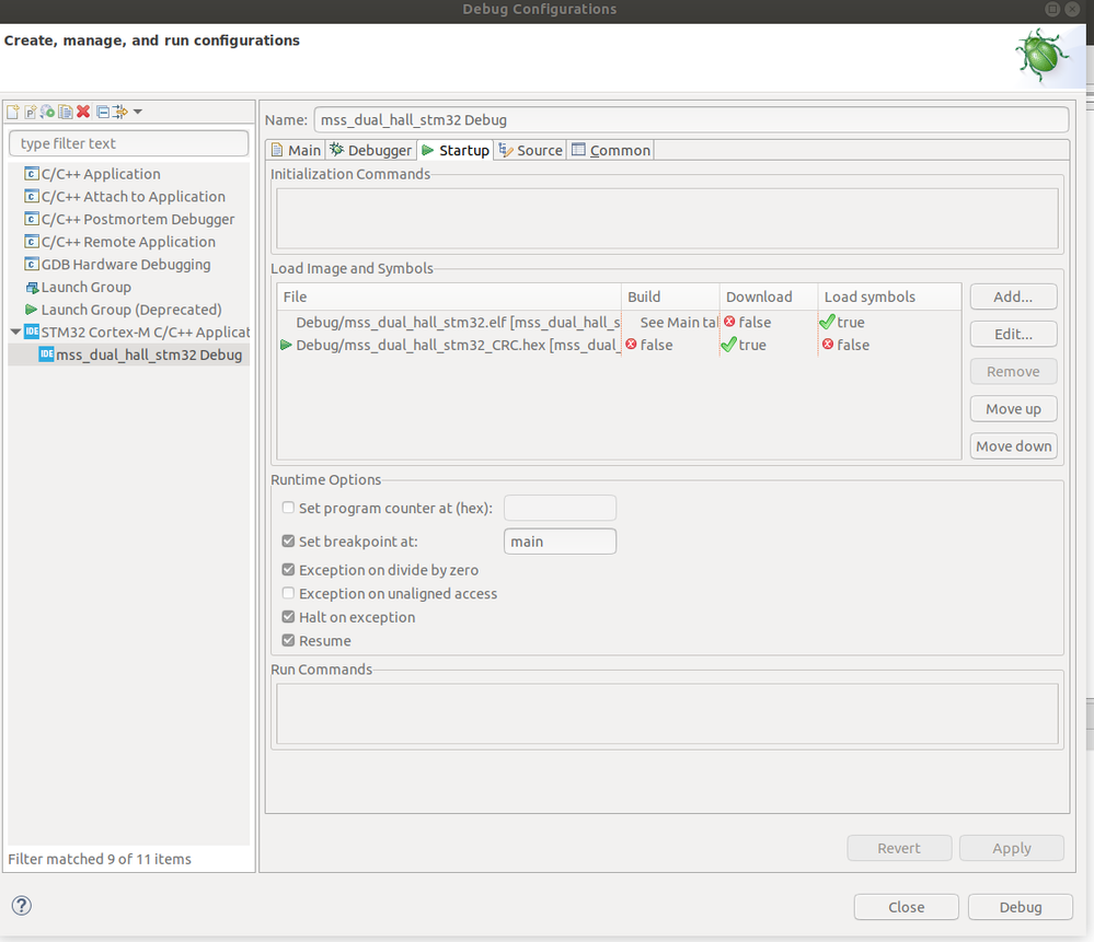

I have been using a linux script generated CRC code instered into a HEX file on some other STM32 products. I am now implementing this for the STM32G431. The GUI is the 1.3.0 IDE. This has changed the debug config.
rclar.6
Senior
I want to specify the HEX file for data into the STM32 and the elf file for symbols used in the debugger. The User interfec has changed though and I seem to only be able to get one or the other (i.e. just the hex or just the elf).
This is a necessary operation as safety critical software need to be able to verify PROM contents
using a CRC32 generated off the target processor. Here is the modified 1.3.0 gui entry for the debugger0693W000000UxhsQAC.png

berendi
Principal
I can't see what's the problem with it. Yes it is supposed to flash the hex file, and consult the elf file for debugging symbols.
Do you perhaps mean that the hex file contains only the crc, and you'd rather want to flash both of them? In this case, enable generating a hex file from elf under Project / Properties / Settings / MCU Post build outputs, then concatenate the two hex files, dropping the last line (EOF marker) from the first one.

Does it happen when you load the hex file generated by CubeIDE post build options too?
rclar.6
Senior
AH Ok just tried this. Loaded symbols from elf and data from hex file. Worked as expected.
I think I must have something going on with srec_cat and the hex file.
This did work from the stm32F processors but maybe its the data length per line or something.
Thanks.

rclar.6
Senior
I think it must be the elf to bin process, as the hex file produced by the compiler and linker
works. It just has a data 'hole' in it. When the elf or the hex file is used the location 0x080001D8
and 0x080001DC contain 0xFFFFFFFF.
When the BIN file derived hex files are used they place zeros here and the debugger, for some reason, ends up being fed
a negative address.
$srec_info hex_from_compiler.hex -intel
Format: Intel Hexadecimal (MCS-86)
Execution Start Address: 080005C1
Data:  08000000 - 080001D7
       080001E0 - 0800810F
OK half way to solving this now!
