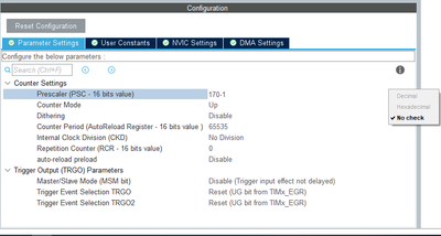

how to reproduce:
  • generate a new C project for Nucleo-G431RB with all default settings.
  • enable TIM1 with internal clock source
  • set the prescaler to 170-1
  • set code generation for TIM to LL
generated code:
/* USER CODE END TIM1_Init 1 */ TIM_InitStruct.Prescaler = 170-LL_TIM_ETR_FILTER_FDIV1_N2;
which is incorrect (and finally killed a motor driver). For HAL code generation, everything looks fine:
/* USER CODE END TIM1_Init 1 */ htim1.Instance = TIM1; htim1.Init.Prescaler = 170-1;

Hello @KnarfB
I'm able to reproduce the described misbehavior. This issue need to be fixed from future releases. But in the meanwhile, you will need to change the cell parameter to "No check" as shown in the screenshot bellow.
Whit this been said, I will raise the issue internally for analysis and fix. Internal tickets number: 1156332 (This is an internal tracking number and is not accessible or usable by customers).
