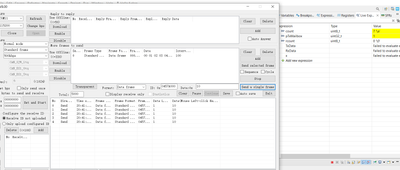

I am using stm32F407VGT board and I am trying to receive data from a can analyzer with stm32 board. I transmit a data to stm32 boards but ı cant receive the messages. I can work on normal mode with two stm32 boards succesfully. The messages are received and transmitted. At the same time, I want to transmit data to can analyzer and I want to observe communication. I attached my main and interrupt source files and I am using USB-CAN analyzerV8 device. The can bps values are the same 500kbps. The modes are same as Normal Mode and I dont define a filter so ı can read every data that ı sent from can analyzer  in live expression on debug screen.
Summarize,
All my purpose, I want to see data that ı sent from can analyzer in my live expression part. I am sending one message fisrtly so there is a one Id.

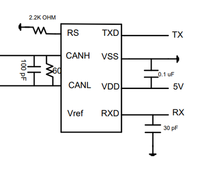

By the way, If  my can transciever circuit mcp2551 is wrong, How can I communicate with two stm32 board ? Could you show me an example transciever circuit with MCP2551 ? I will use that
See this thread the picture shared by the community member on his first post.

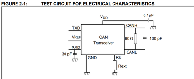

I changed the terminal resistor with 120ohm on my can circuit and It still doesnt work. I cant understand my boards can communicate but why the analyzer can't ? I attached my can transciever circuit . I changed 60 ohm with 120ohm
SofLit
It seems you used "Test circuit" description for your project while this is not the right config:
So is that possible to:
  1. Remove the following capacitors?:
    • The one connected between CAN_H and CAN_L
    • The one connected to Rx pin
  2. Remove the 2.2Kohm resistor and connect RS pin to the ground

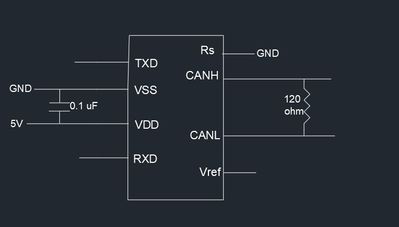

Hello again,
I readjusted my mcp2551 can transciever circuit and my codes. I attached them. But It still doenst work guys. The prgoram is not getting in canrxfifo ınterrupt function or I cant transmit data to analyzer. Maybe, the analyzer sends hex codes not decimal so can I read hex code data in my live expression panel ? I mean, should I decode  the data in my codes ?

Attach your project. Draw up a diagram on how you've connected the MCP2551 to the STM32. How you've connected the CAN analyzer to the MCP2551, including power supply, USB connector(s) and grounds.
