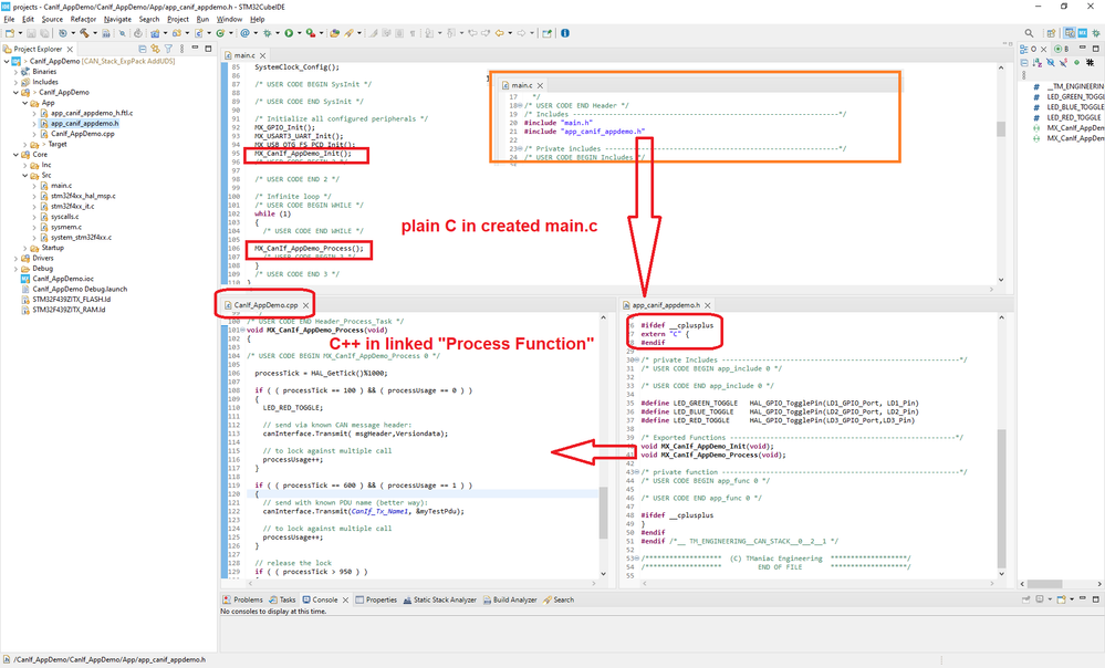

I created a new empty STM32 project and selected C++. Now I made two functions
void test(uint8_t a)
void test(uint16_t a)
But I get an error of redefining the function test. The file (like all source files) has the ending .c and if I change it to .cpp then it works. But if I change any of my other source files to .cpp the functions in those files are not found any more. If I leave the ending .c then I cannot overload functions. What is going on here???
The STM HAL is written in plain C. And the main.c file will be in C too.
I don't know what the C++ switch on creation works :smirking_face: Maybe it comes from standard Eclipse window "create a new project". I was confused about it too.
You can write you own code in full C++ and call to it (in plain C style with the extern C linkage).
Do you have played with some STM tutorials/examples? They have a nice way to do it.
The picture shows my way (based on the STM idea). My "application", "Middleware" and "Driver" are written in C++.

This is very basic.
STM32CubeIDE is based on gcc compiler.
*.c files will be compiled as plain C and *.cpp will be compiled with C++.
Overloading is a C++ thing and not allowed in plain C.
If you use C++ you must pay attention on the namespace of a function. Maybe you must deal with it over the header file where you publish you functions. But keep in mind you can't use the overloading inside a *.c file like the main.c.
If you want to use a C++ function (in a *.cpp file) within C, you need to define them with C linkage using extern "C".

Thanks for the replies. I know only c++ supports overloading. The point is that I created this project as a C++ project. So I expected all files to be .cpp in the first place. What difference does it then make if I create the project as C or C++ project? I would like everything to be C++.

Thank you for the detailed answer. I still get the "redefined" error for the functions in some files. Strangeley in some it does work (?). I have not idea what is going on. I never had this strange behaviour any where else. I guess I will just stick to c for now.
You must not use overloading (or other C++ specific things inside the headers that you include to a plain C file.
If you want to use only one header file there must be a wrapper function and excludion of the C++ stuff
For example this header should work:
