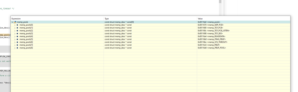

Ok, So I've tried to not use these files I have mentioned above and started a fresh project and used integrated into LwIP libraries. So after reading comments / instructions in tcp.c file I tried to create project with these instructions. But somehow I still get a HardFault.
So these are the steps:
- Created a new tcp_pcb with function tcp_new(). there the problem begins where function can't allocate memory for new pcb. Functions does not create pcb with state = CLOSED. ok next..
- when I call tcp_bind() function I get a HardFault. I think there is some problem in memory allocation. Bellow I will also attach picture of memory pools that LwIP or whatever creates. What I can see from the memory map they are not incorrect so I don't know what the problem could be? maby I need to configure MPU so the MCU can acces those memory pools?
also STM goes into HardFault at line 683 of tcp.c:
LWIP_ERROR("tcp_bind: can only bind in state CLOSED", pcb->state == CLOSED, return ERR_VAL);
