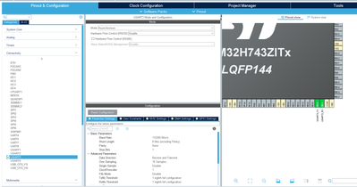

Well, you don't see anything via Putty or Teraterm because you parameterised USART3 correctly (asynch, 115200 Bits/s, etc) but accidentally stumbled over the pin multiplexing. In the STM32H743, PB11/PB10 is unfortunately selected as the default for USART3 RX/TX, but in the NUCLEO-H743ZI (MB1364) PD9/PD8 are connected to T_VCP_RX/_TX via SB12/SB19. So the USART3 permanently writes the data to the TX channel - but you have checked on a different TV channel... :smiling_face_with_smiling_eyes:
Solution: simply remap the alternative pins for USART3_RX/TX in the CubeMX overview of the STM32H743ZITx as described in UM1718, section 4.45:
To manually remap a function to another pin, follow the sequence below:
  1. from the Pinout view, hold down the CTRL key then left-click on the pin and hold: if any pins are possible for relocation, they are highlighted in blue and blinking.
  2. drag the function to the target pin.
...i.e. drag them one after the other to PD9/PD8.

Hi! I am trying to fix it... I created a new project just using the things i need to do this.
So first i make a new project in stm32cubemx, i choose my board, then i go to connectivity and i configure it like in the photo:
Then i generate code, i write between /* USER CODE BEGIN 3 */ and /* USER CODE END 3 */ the next lines:
Then i build my project, open tera term clicking on new connection with the same baud as in the upper photo here and nothing appears in the screen...
What am i doing wrong?
Thank you!
Peter BENSCH
Well, you haven't posted an IOC file, so you can't see where the error might lie.
By the way, you can also insert source code instead of screenshots if you click on the three dots in the text field at the top right and select </>.
I have thrown your three lines of code into an otherwise empty project for a NUCLEO-F767ZI as a test - it works, both with Teraterm and other terminal programs if you have selected the correct port (STMicreoelectronics STLink Virtual COM Port):
