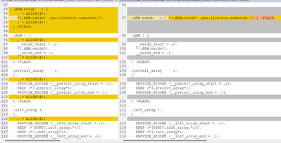

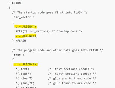

1. Whether to add ALIGN(4) even inside the FLASH sections present in STM32H753BITX_FLASH.ld (attached)
2. The file generated by STM32CubeMX (ran from within STM32CubeIDE) generated a STM32H753BITX_FLASH.ld file in the project folder. It does not contain sections that reside in RAM_D2 and RAM_D3. Attached the STM32H753BITX_FLASH.ld.txt file for reference. Is there a way available with STM32CubeMX (preferably) or with STM32CubeIDE to add the necessary RAM sections in the LD file for STM32H743BITx?

1 > Whether to add ALIGN(4) even inside the FLASH sections present ..
yes, in all sections.
2 > .. as TDK told : you have to set, what you want.
3> I dont know , what you ask about, i just set the sections as i want and it works. (on H743 )
RajeevAroraCrcEvans
Hi  @Khouloud ZEMMELI , @AScha.3
Since answer to my first query is Yes, I believe the default STM32H753BITX_FLASH.ld file provided/added by ST should be updated to include the ALIGN(4) in all sections (especially in the FLASH sections). I would request ST / Khouloud (and her team) to update STM32CubeIDE so that the updated file is available when user generates the code.
The linker script already has alignment to 32-bit words.

RajeevAroraCrcEvans
Thanks @TDK  for a quick response.
I observe below when comparing the file that my team uses (on left) and the one that STM32CubeMX generated (on the right):
Regards,
Rajeev
