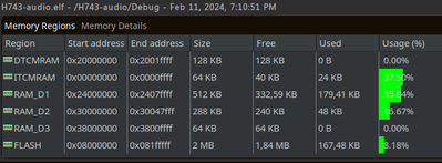

I use ITC for stack and heap, D2 for circular DMA (always running), D1 for all other:

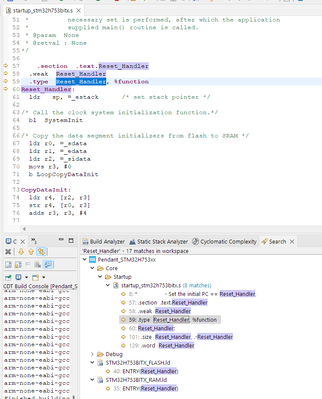

Concern: Before I send the HEX (for testing) I want to ensure that all the used RAM sections are receiving clock.
I need to code for a new board/PCB-with-microcontroller that is currently not available with me. I can only send the generated HEX file to one of my teammates in a different country (for occasional) testing.

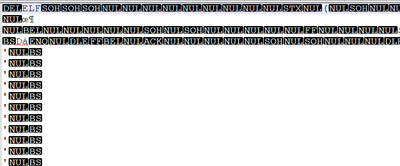

I tried looking in the ELF file, and I only observe below. I even tried searching with RAM_D1 but the search did not produce any result. Am I missing something in settings due to which I do not observe information similar to the snippet that you have shared?

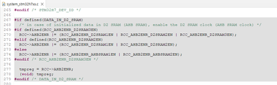

Below is the snippet from the system_stm32h7xx.c file. The code part has a greyed background which means that the code part is disabled.
This means that even line number 270 is disabled (which is the code line that you have shared in your response).
Now if I try finding the macro (DATA_IN_D2_SRAM) used on line number 267 the macro is commented out.
Thus I am unable to understand which part of code (generated by STM32CubeMX and being compiled using STM32CubeIDE) is enabling the clocks to the RAM_D2 and RAM_D3 sections.
Also, my code currently does not call below macro. Does your code call the below macro in main() or some place else?

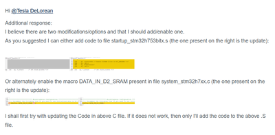

‎2024-02-11 8:30 PM - edited ‎2024-02-11 11:18 PM
Additional response:
I believe there are two modifications/options and that I should add/enable one.
As you suggested I can either add code to file startup_stm32h753bitx.s (the one present on the right is the update):
Or alternately enable the macro DATA_IN_D2_SRAM present in file system_stm32h7xx.c (the one present on the right is the update):
I shall first try with updating the Code in above C file. If it does not work, then only I'll add the code to the above .S file.
Previous response:
I am compiling code using STM32CubeIDE and the code was generated using STM32CubeMX.
I only find below references for Reset_Handler. I do not find the line number 7 that is present in the snippet you shared. Which file should I look for the code snippet that you have shared?

‎2024-02-12 12:16 AM - edited ‎2024-02-12 12:19 AM
In the same file could you please check for whether below macro is defined or not:
DATA_IN_D2_SRAM
The solution seems to be one out of below. I am unaware how to copy the link to the post and share it here, hence sharing the snippet.
‎2024-02-12 12:48 AM
Also in system_stm32h7xx.c :
