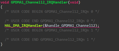

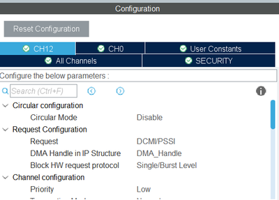

OV2640 is used as the camera module and I want to use GPDMA when I send DCMI data.
If MX sets up like this and generates code
There's an error like this (handle_GPDMA1_Channel12' undeclared (first use in this function); did you mean 'handle_GPDMA1_Channel0'?)
So please let me know how to use GPDMA in DCMI or OV2640, in STM32U5AZJ.

    Hello @achovy and welcome to the Community :),
    -->There's an error like this (handle_GPDMA1_Channel12' undeclared (first use in this function); did you mean 'handle_GPDMA1_Channel0'?)
    Thank you for bringing this issue to our attention with GPDMA: Standard Request Mode. I reported this internally.
    Could you please add in main.c under Private variables this line:
    DMA_HandleTypeDef handle_GPDMA1_Channel12;
    and in STM32u5xx_it.c under external variables this line:
    extern DMA_HandleTypeDef handle_GPDMA1_Channel12;
    Also you can use the GPDMA Linked-List mode without issue. For that I recommend you to refer to  the DCMI_ContinousCap_EmbeddedSynchMode example. This example can help you to start with GPDMA and DCMI.
    Also, please take a look at AN5593 How to use the GPDMA for STM32 MCUs precisely section GPDMA configuration for graphic peripherals.
    Internal ticket number: 180281 (This is an internal tracking number and is not accessible or usable by customers).
    Thank you.

    The issue is fixed in STM32CubeIDE1.16.0 and STM32Cube MX 6.12.0 versions.
    Thank you.
